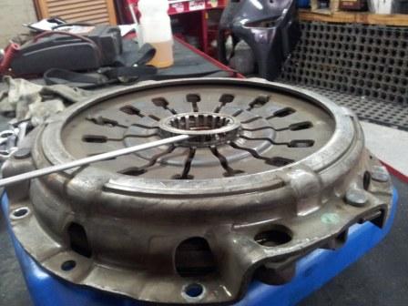

Hi yes Cats is correct. The clutch is a pull type and not a push type. You will need to look through bell housing and use a long thin screwdriver to pry off the ring from the clutch fingers. see pic.
