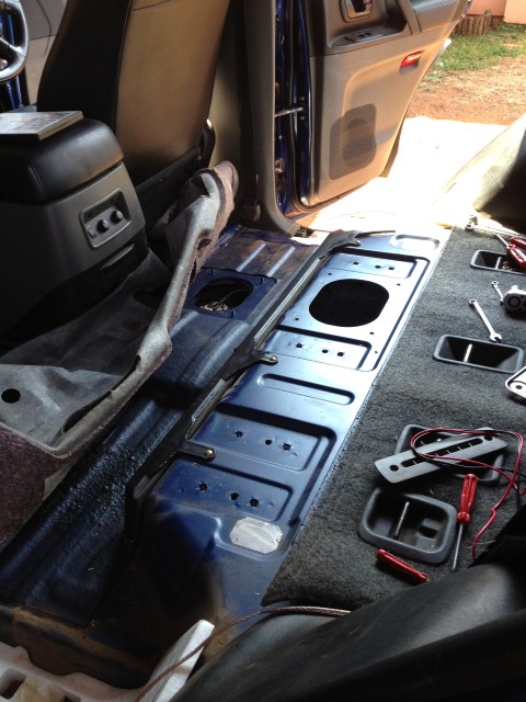

ok , so I figured it out on my own, and this is what I did.
First remove the middle seats
Then remove the A/C vents from the carpet and the top cover plate for the fuel pump that sits under the seats.
Then rol up the carpet and you will find the cover for the fuel sending unit
about in the middle where your feet goes when you sit on the seats
Unscrew the cover and unscrew the sender unit , unplug and slowly pull it out.
you need to take off the metal plate to get to the thingy that goes up and down , I just cleaned it and sprayed some electro clean on the parts and then tested it to see if it works.
while testing move the flout up and down too see if you get different readings ( must be pluged in and car ignition on- not started)
you can then also test to see if your fuel light works
sorry the photos is from end to start

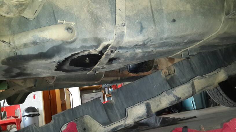

Hi guys, just to revive an old thread. I did the clean of the fuel gauge sensor in the tank, it works perfectly out of the tank, but not when it is inside. So I removed the plastic fuel tank cover, and found the dreaded dent right below the fuel sensor float...
Dent under plastic cover 1
Dent under plastic cover 2

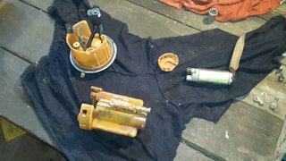

I then removed the Seats and carpet and took out the fuel level sensor and fuel pump/filter assembly. I then drained the tank completely with the drain bolt and the last remnants with a home made catch bottle, two fuel hoses and rubber duck pump connected to the vacuum port.
I then mopped up the last drips of petrol and dirt with a rag in the tank to make sure it was as safe as possible to work in the tank. I then (with a fire extinguisher very close) took a thick wooden pole (pick handle) and a 4 pound hammer and proceeded to carefully tap the dent out through the fuel sensor hole. It moved out/down by approximately 40mm, and when I put the fuel sensor back in it worked through its full range as the yellow light came on immediately.

I also gave my fuel filter a bit of a clean/flush while I was there, I rinsed it out in reverse with clean petrol - lots of rusty debris came out, will have to get a new on as soon as I can.
