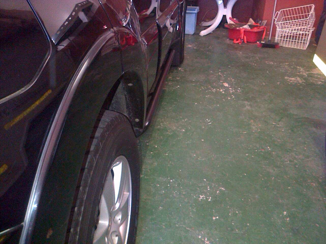

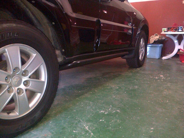

Hey there. I helped John by designing the bottom slider section and we both installed that on out cars. John then went and had the round tubing added by someone in Bloem, looks very good but I haven't finished off yet. Here are some pics of John's finished product:

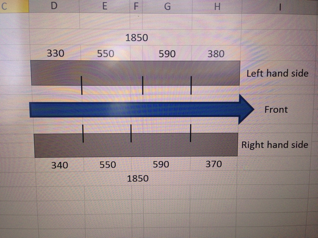

Hi Piet. Let me see if I can find the design, I had it on my old work laptop but now with the new laptop I can't install my CAD programme. Otherwise I will try give you some details from memory/measurement.

The picture shows the top view dimensions of the bracket positions, I used 76x50x3 rectangular tubing and the brackets were 50x6mm flat bar, slightly overlapped to give two weld points for added strength. The hole positions are on the cad drawing which I cannot open, I used Draftsight64 to draw them.
The measurements above are in mm, and the flat bar is welded on perfectly upright and straight. I got the hole positions by taking a piece of plywood and marking the holes with a pencil, the challenge is to get the height correct so that the slider sits about 5mm from the body edge to allow for some flex.
Sorry I can't give more detail at this time. Cheers.
