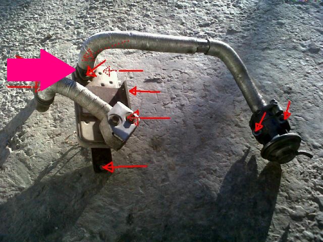

I checked for error codes, and found none. So, I decided to do a CAT Delete (The Filter seemed okay without any major blockage) and followed it up this past weekend with an EGR Delete. Also replaced the Diesel filter. My thoughts behind the EGR Delete was that some of the carbon buildup and black yuck could have come loose and maybe blocked an injector or something. In my opinion it simply does not make sense having an air cleaner to keep dirt out of your engine, while you blow in dirty air from another place.
Any case, followed a great post by Marius (https://www.pajeroclub.co.za/forum/view ... =52&t=2502) on the EGR delete. When I took the contraption off, one of the holes into the chamber marked with a pink arrow on the picture (Thanks Marius for the picture), was completely carboned shut.

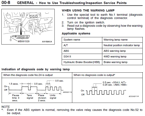

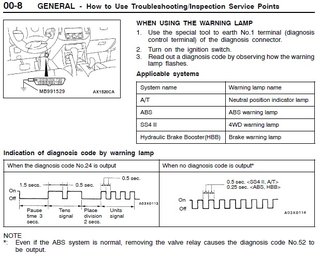

Regarding the error codes, Under section 00 (general) in the workshop manual, they describe the following:

From what I've read, an OBD scanner won't work on the Pajero. Mitsubishi are using MUT-II.
