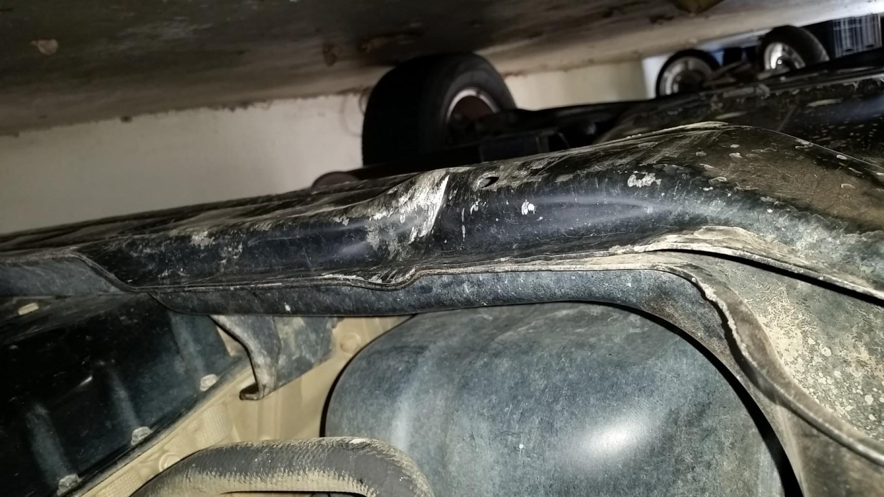

So by real bad luck on a gravel road I missed a rock in the road on Sunday (momentarily distracted by kids) - it lodged against the cross bar and road, shearing the 2 mounting bolts clean out of the chassis as well as shearing the mounting rubbers at the case. Speed was very slow about 20km/hr.

Impact Point
Impact Point

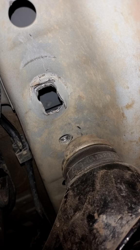

Mounting bolt pulled though Chassis

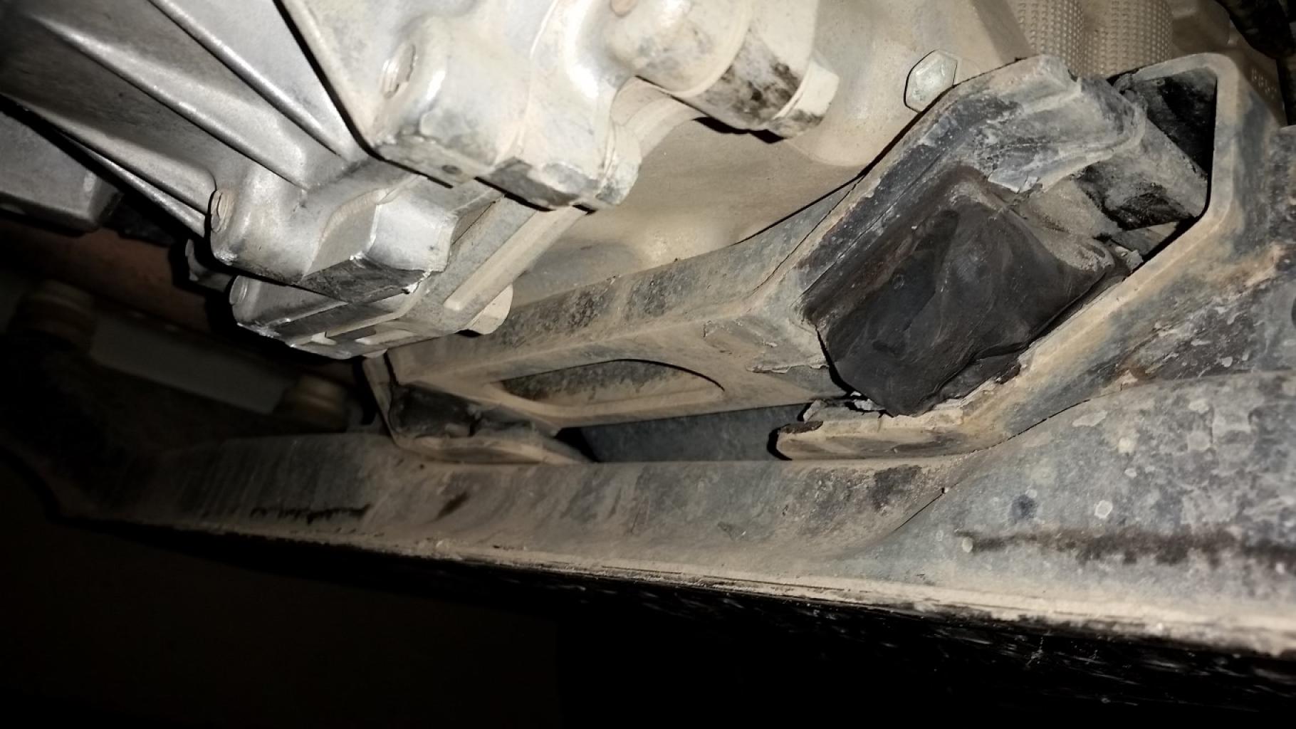

Sheared mounting rubber

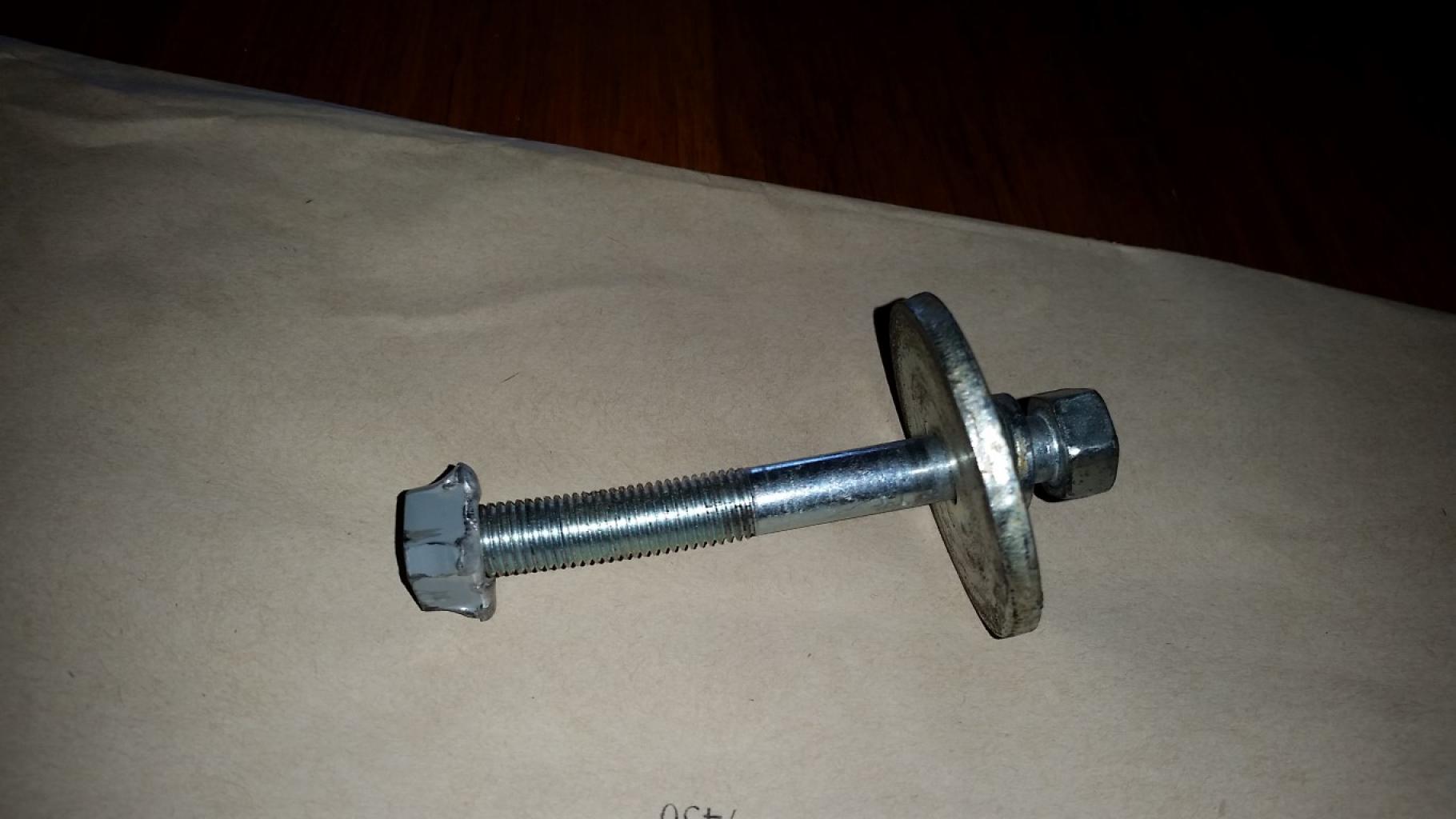

Bolt with Nut that pulled through the chassis

Cross member is probably repairable but it is quite buckled - the holes are in chassis where the mounting points were ripped out - quite correct will need someone to cut out a piece chassis and re-weld in a section with captive nuts in right position.
Big issue I have now is the gearbox mounting rubbers which go between the cross member and the gear box - there is no stock in the country so this is ex Japan min 21 days!

So the repair turned out to be pretty complicated in the end as the chassis was quite badly deformed round the area of the rip out. It was localized but enough to make a quick repair difficult. This is compounded by the fact that there are 2 layers of steel sandwiched in this area to give extra strength.
In the end with the threat of warranty issues etc I let insurance take its course. Repair bill was a whopping R28 000 which I settled the excess on. They cut out this area and replaced the steel with captive nuts with a thicker plate behind - my only worry is corrosion but it was well Tectyled inside. Ill keep an eye on it.
