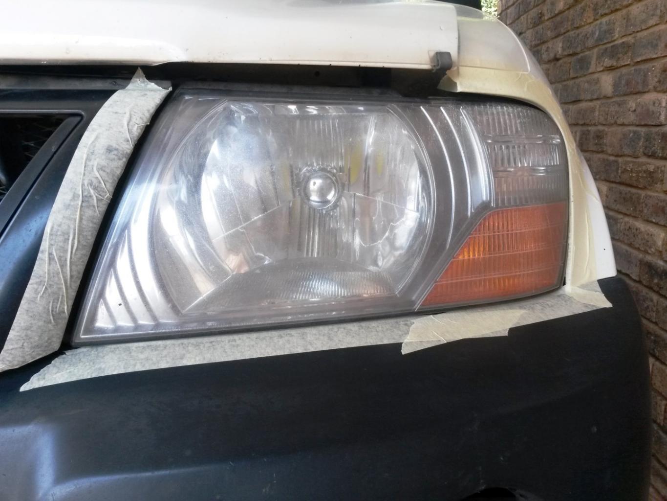

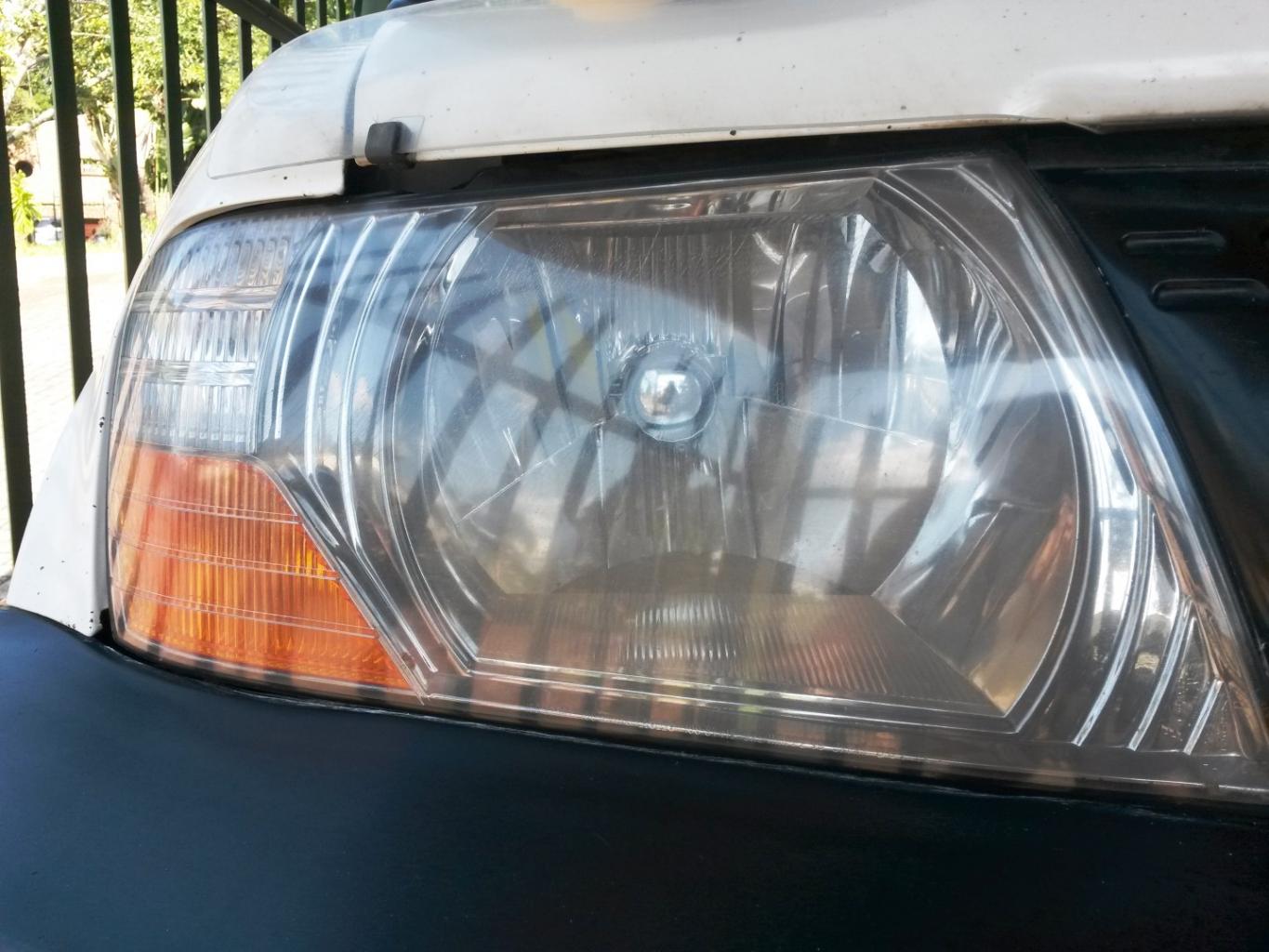

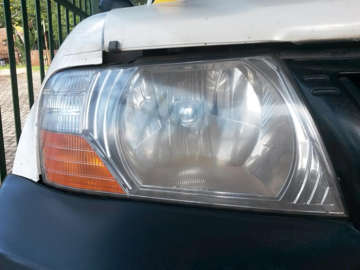

My 2005 3.2DID Pajero's "plastic' headlights became very faded/yellowed and I looked into buying new lights or 2nd hand units to replace them. However, the prices are just absurd and I looked into how to restore them.

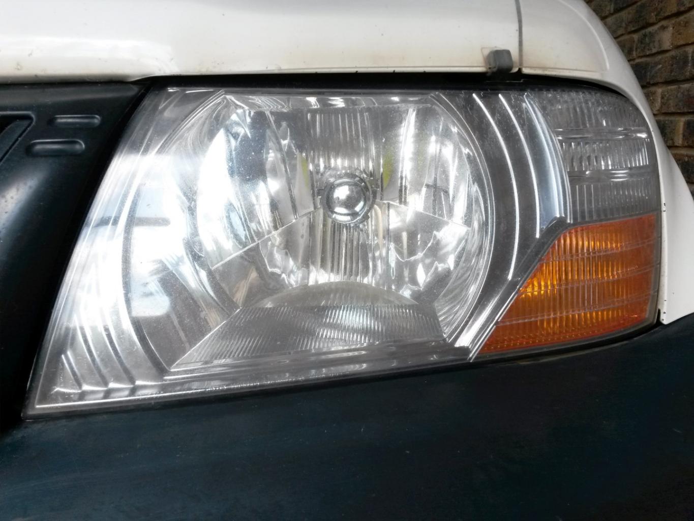

I was skeptic at first, but the results speak for themselves. I am impressed. See the pics below. My RH side headlight was faded WAY more than the LH side - I think it's how the RH side of the car gets more sun than the LH side, where it stands under the carport.

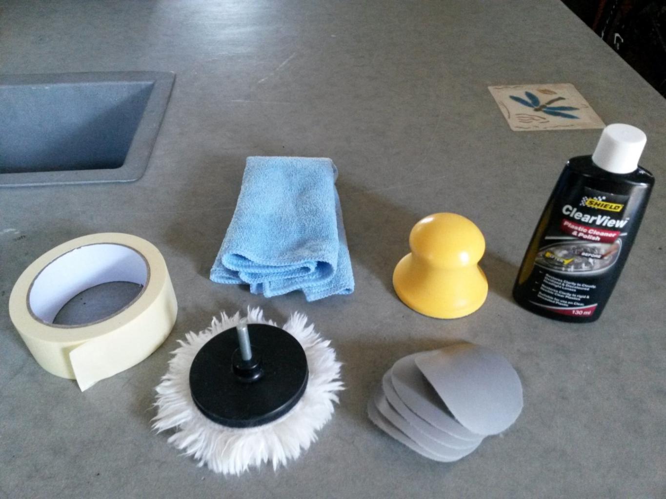

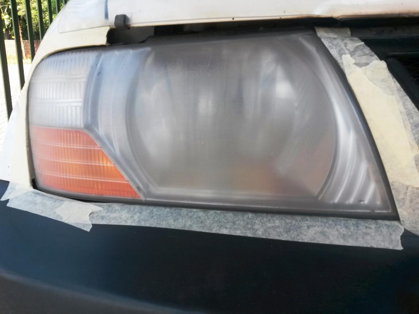

For R250 it's worth it (at Builder's Wharehouse). You dont need to buy the whole kit if you have 1200 & 1500 grit sanding paper, a sheep's wool buffer, masking tape etc - you can then only buy the the larger version of the small bottle polish/repair fluid shown in the photo.
Will check tonight how my newly installed LED globes work with newly polished headlight lenses.
*I only sanded down the RH side headlight as it was faded the worst. The LH side headlight was not sanded down, it was only polished.
**After completing the restoration, I polished and buffed the headlights with Shield's car polish @ R60 - this is done for UV protection. Others apply a spray on UV resistant clear coat.

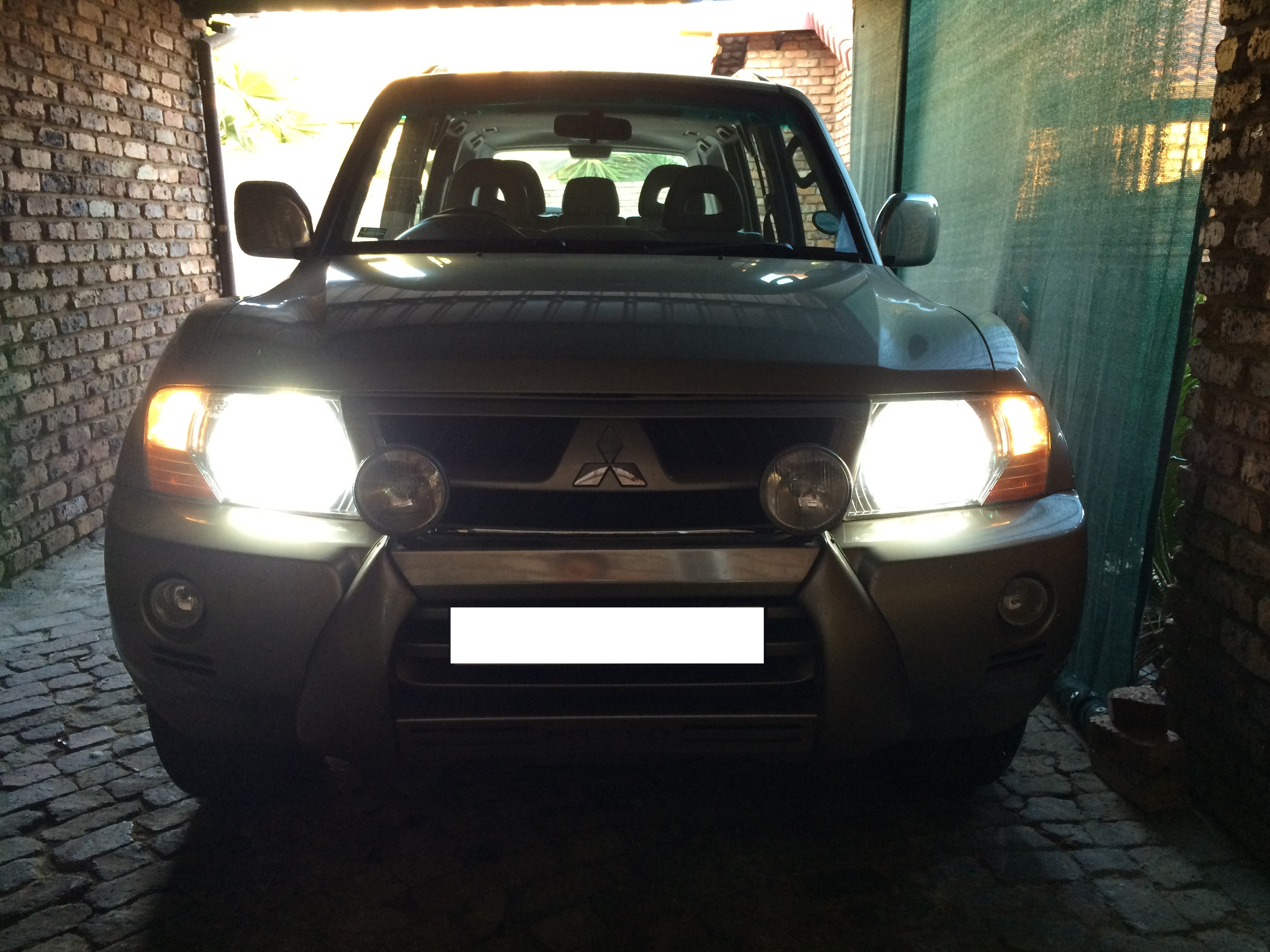

It is money well spent. I had OSRAM Nightbreakers in previously, but these normal LEDs outshine them hands down. They provide such a nice white light, the difference is clearly visible. I did not want to spend a whole lot of money, so I just bought the ones on special back then.
Spend a few extra bucks and buy even bigger ones - I am sure you wont even need spotlights if you go for the bigger LEDs.

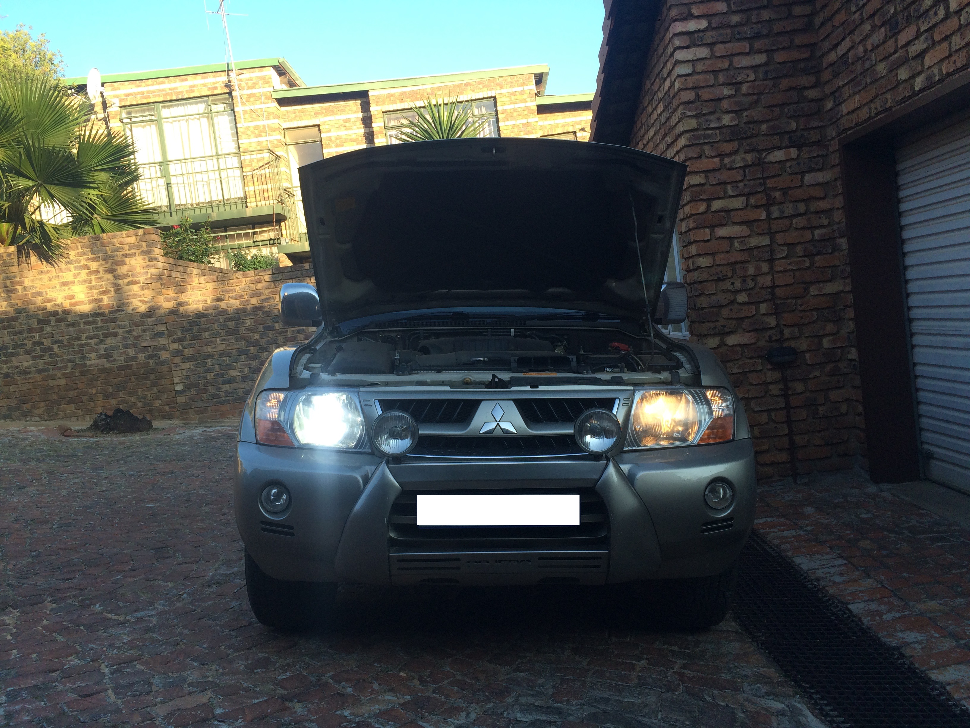

Installing LED replacement globes is very simple, only a little more hassle than replacing normal globes. Thanks to macjohnw also on this site for the idea.
I paid R2000 for a set from extremelights.co.za and I transformed my 3.2 DiD from shy at night to an enlightenend beast.
The one pic shows the difference between the LED and standard H4 globe. Unfortunately my phone takes very poor night time pictures, otherwise I could post that as well. What I can report is that the beams are clear and does not blind any unsuspecting oncoming travellers. Happiness. Now to fix and replace my fog lights.

The LED globe itself is shaped to use the existing reflective enclosure of the headlight to angle the beam. I find that the beam thrown has a distinctive edge where the light 'stops' so there is no glare that you find with many HID conversions.
