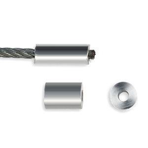

Cool. What type of ferrules did you purchase?
Re: Driver side window
Used these. Crimp them with a side cutter if you don't have a crimping tool.
