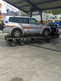

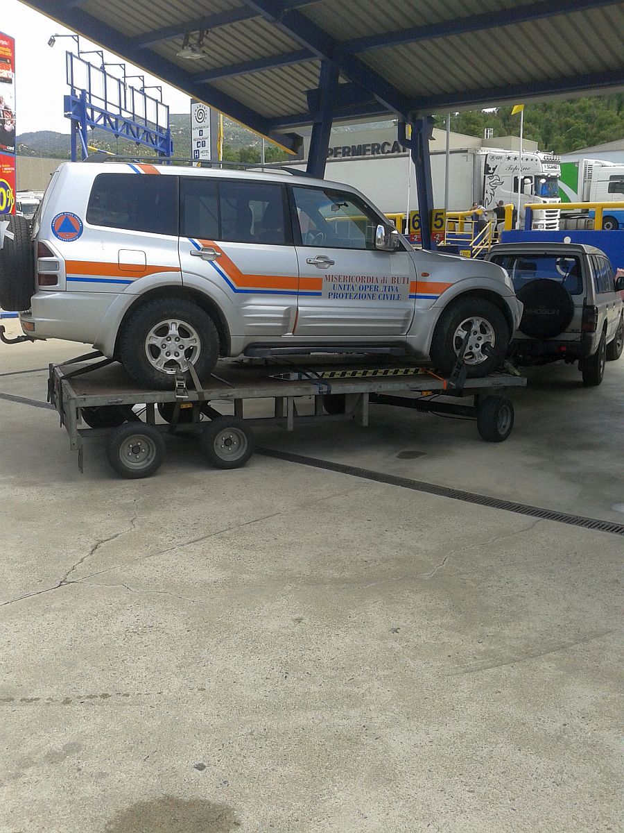

Talking about this one, at the french spanish border
