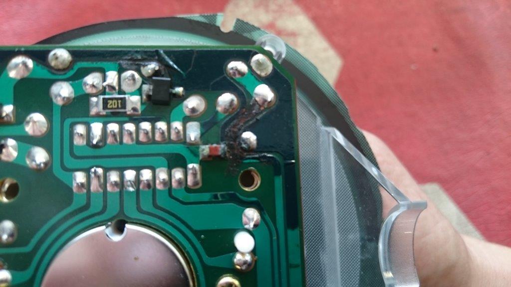

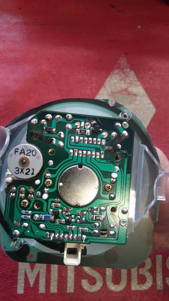

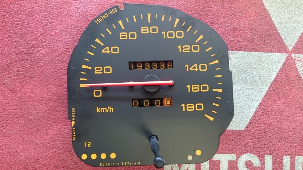

I had a similar fault on my Japanese import Pajero - 1995 LWB 2.8 Turbo diesel. Lovely vehicle with many features not available on the local vehicles then. It had an automatic gearbox with electronic overdrive.
At 193,000 km suddenly the overdrive would not engage and the speedo stopped working.
It turned out to be a burned circuit on the back of the speedo. How or why no-one knows. I imported a new speedo unit from Japan hoping that this would solve the overdrive problem, as the speedo "talks" to the gearbox - but to no avail.
I've attached a couple of photos to give you an idea of the burnout.
Good luck & regards,
Roger
