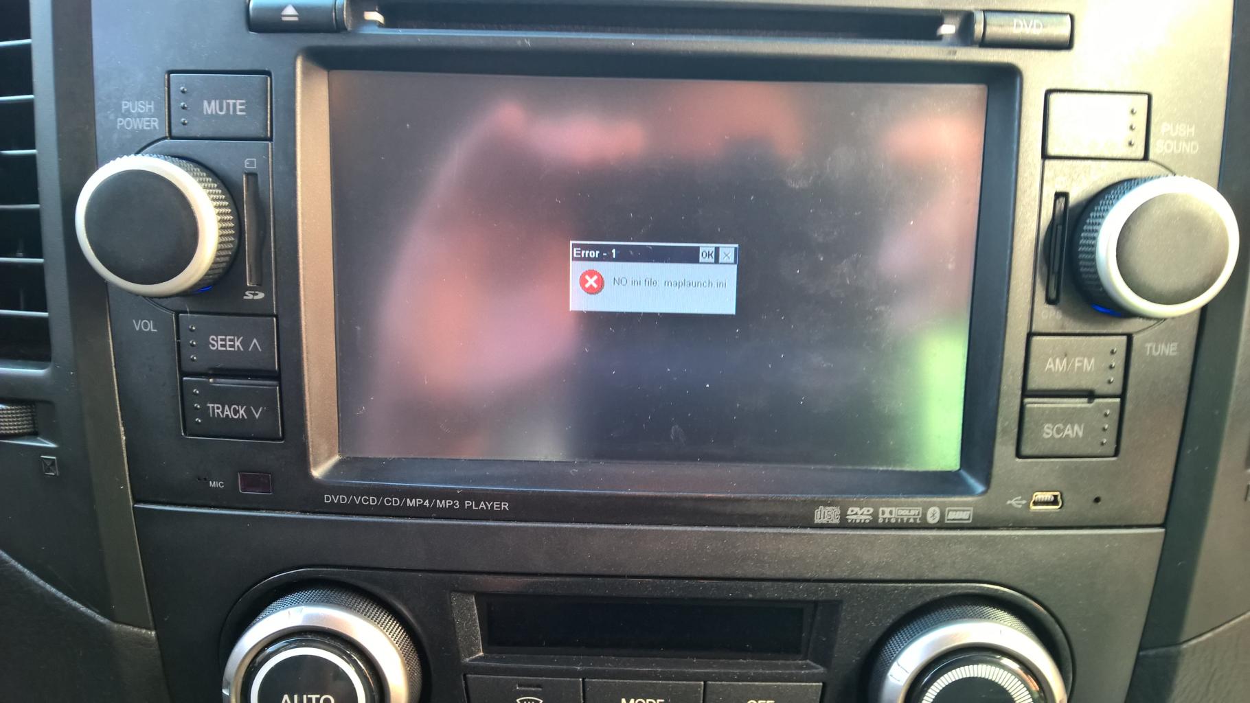

:roll: aghh cats - orraaity then - attached please find? :ugeek:
btw it is the caska ca3649.
best regards,
deon

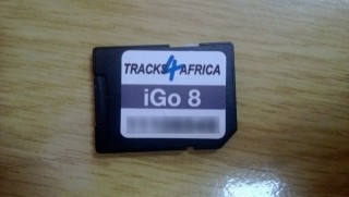

Images of my SD card attached as purchased from Planet Electronics many years ago.
