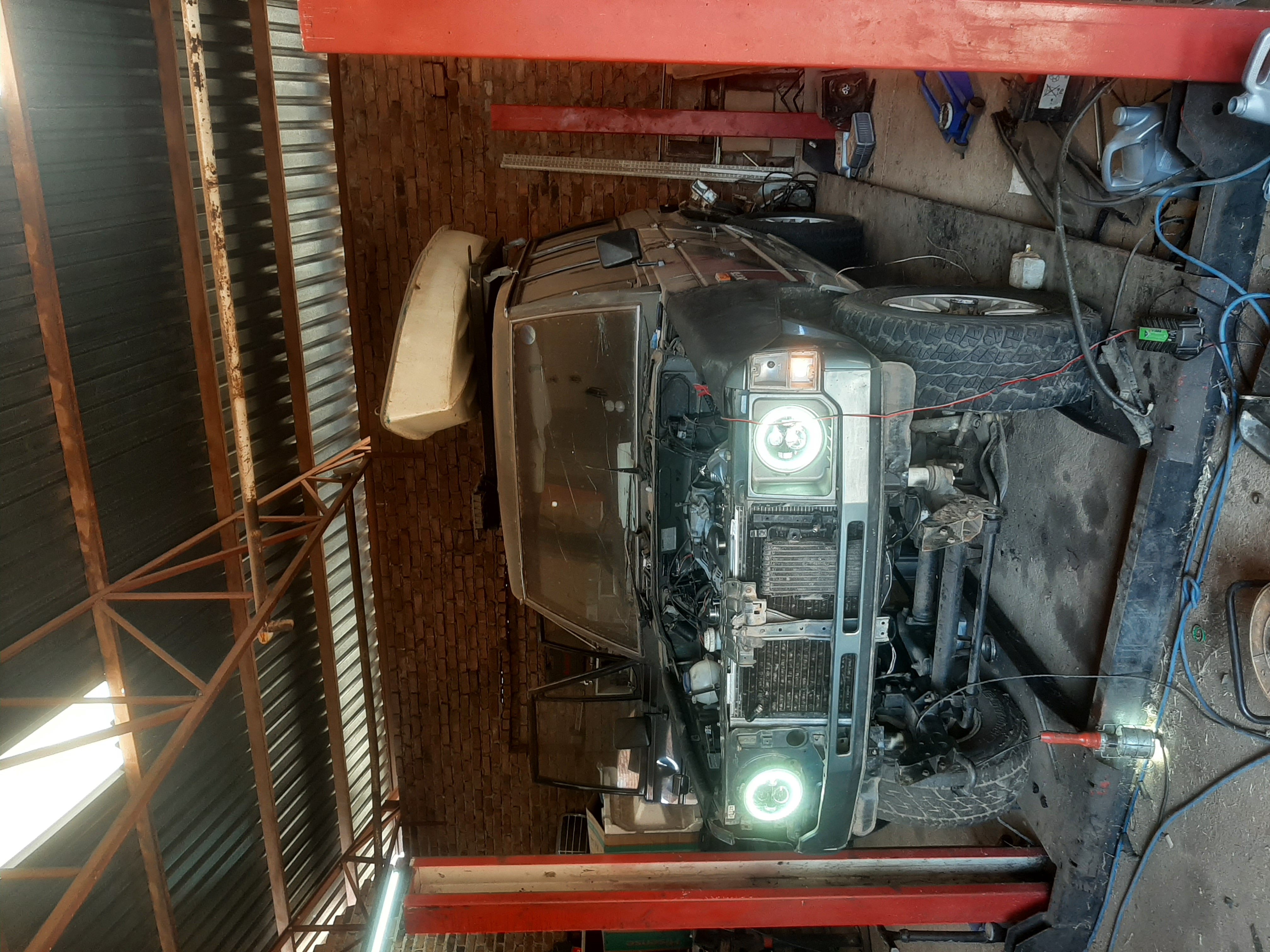

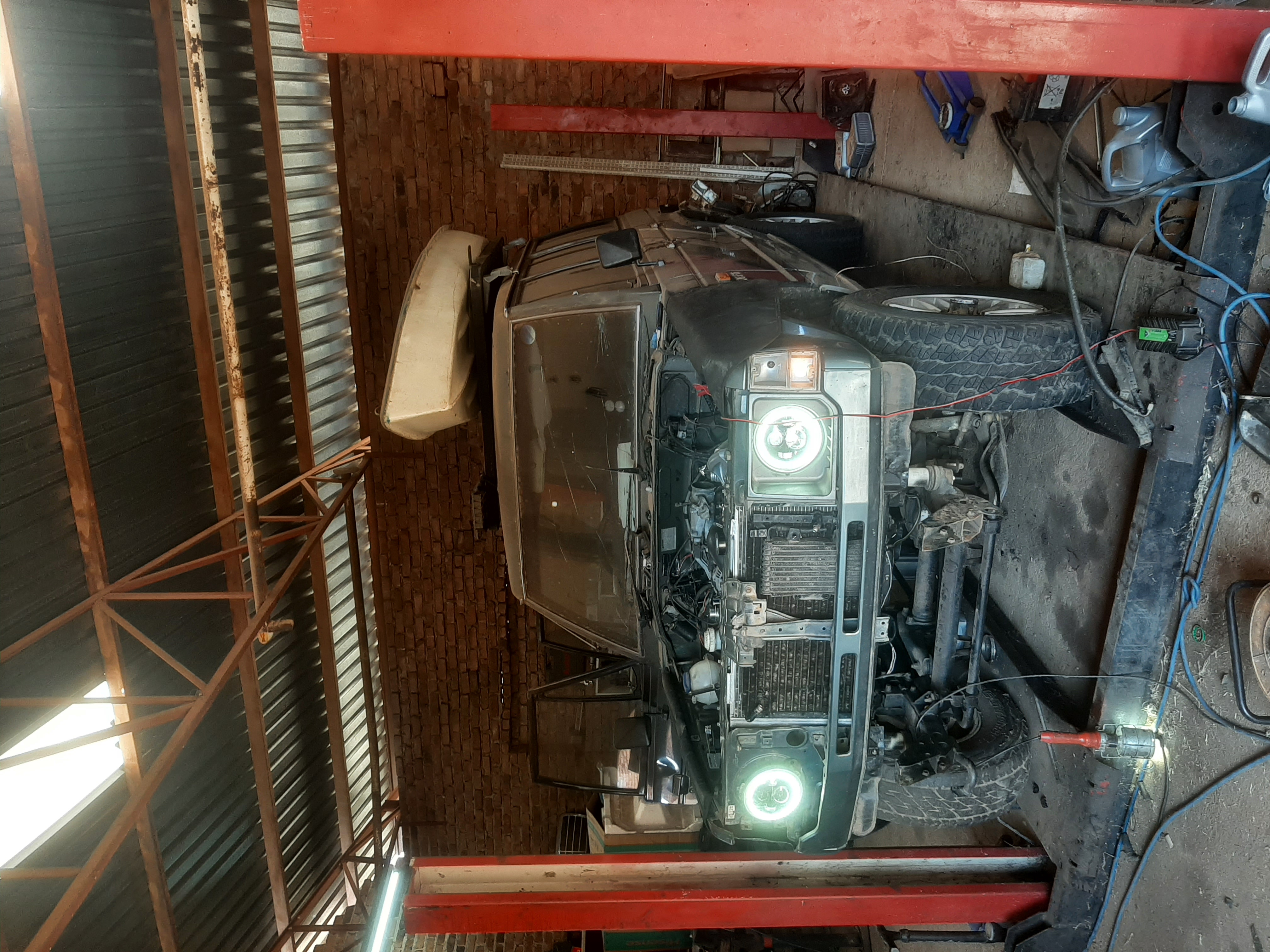

Yes i am still busy with this build! Since my last update i have been able to get it wired up(for the most part) and got the engine running , and even drove it to the other side of the workshop with alot of custom work that i might showcase later. Then another 6 months went by of stairing at it.. i am currently busy mounting the Ac condenser(yes the ac wil hopefully be working) and the Gearbox oil cooler which is of a gen 3 Auto pajero. Next i need to build a exhaust, because open headers is just too loud to run
