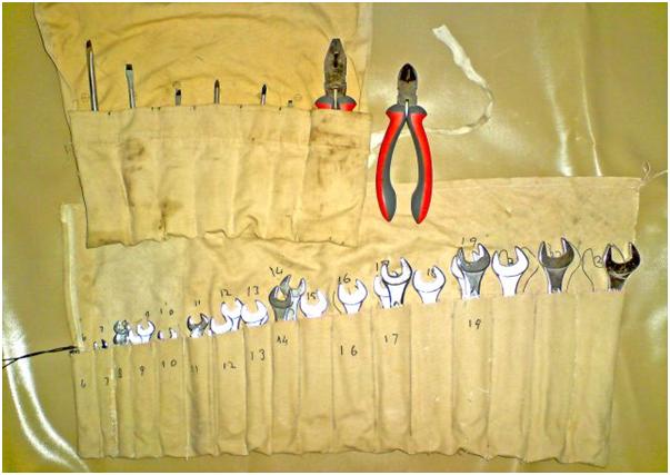

Ingenuity and determination alone is not going to do the trick, you will need some tools. The cheapest rubbish is better than not having any but I would recommend getting a fairly decent set of tools. It does not have to be snap on quality but the pressed steel excuses that one finds in the fancy plastic boxes with 101 bits in does not cut it, they are designed to be bought by lay people and to spend their time tucked away in some cupboard, never to be used.
Firstly you need a set of ring set spanners from 8 to 19mm. these are the ones with a ring on the one side with an open end on the other side.
Next follows a set of screw drivers with flat and star points.
Throw in a sturdy pair of pliers and a sharp side cutter and you are halfway there.
The above mentioned tools are what I would consider as being the bare minimum, I have a canvas roll that all fits in to as permanent residents in my Pajero. Tip Take the weef’s sewing machine and sew a canvas or fabric rollup caddy for the tools, it not only keeps everything together and stops it from rattling but also enables you to spot anything missing when you have finished working.

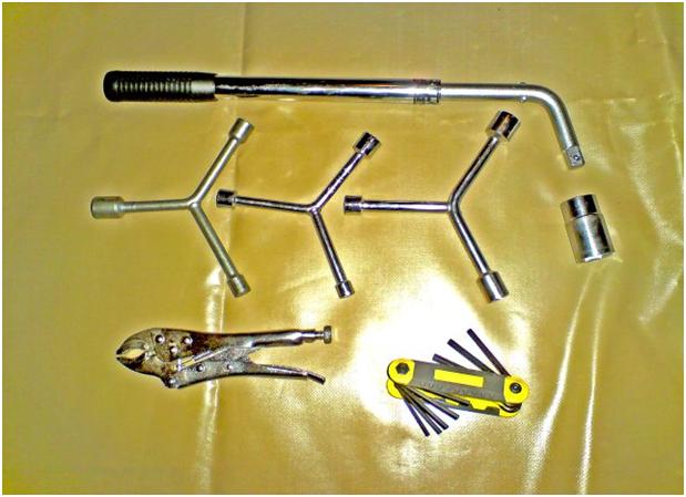

To expand the basic toolset I would add a good shifting spanner and gas pliers. These are two tools that you really don’t want to skimp on as it can create more problems than it solves. The cheaper units do not grip the bolts properly and are prone to slipping and in the process rounding off the shoulders of the nuts or bolts not to mention the bruised knuckles and blood loss that accompany these little slips. Another essential is a decent wheel spanner as the last thing you need is for the cheapie that came with the vehicle to break leaving you staring at the flat wheel on the car while the perfectly serviceable spare remains firmly on its bracket. I use one of these extendable units that can double as a ½” drive power bar. Tip invest in a 24 socket as it is needed to remove that plough of a tow bar of yours when doing the off road thing. I have found a very nifty set of box spanners at Midas that come in handy when access is compromised. Allen keys are another one of those handy bits to have and do not take up too much space and with a pair of long nose pliers and a couple of vise grips should round off the toolset.
You will notice that on the smaller sizes of spanners I carry doubles as one often have a bolt and nut of the same size and you need two spanners to loosen it.
That should take care of the basic essential tools and with a few nice to haves and essential spares you are on your way to becoming a self sufficient bush mechanic.

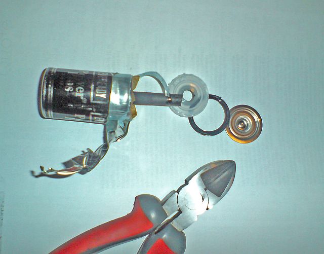

The horrid moment has arrived. You have opened the alternator and found the brushes worn down and your toolbox is not the local Midas that is 300km away. You do not have as spare set of brushes and you are stuck. Not so, the bush mechanics on page dirty advises:- Grab the first torch with normal batteries in and take one of the batteries out. Note it must be a normal and NOT a rechargeable battery. Normal batteries are zinc carbon units and the carbon is exactly what we need. Use a side cutter and remove the outer cover of the battery. Do not worry as there is no battery acid or messy stuff inside and we do not go deep enough to get to the paste.
Looking at the photo you will see that it has a metal outer cover and then a plastic inner cover followed by a cardboard housing. In the center there is a carbon rod that makes up the positive of the battery. This is what we need and it just slides out with a bit of gentle persuasion.
Cut to length and sand down to the correct shape and viola you have a new brush.
Cut the old brush off keeping as much of the wire securing it to the unit. This is wedged under the spring and the new brush is inserted in the holder and the alternator is reassembled. On the mitsu alternators you will find a small hole on the back of the unit. This is to insert a short piece of stiff wire to hold the brushes away from the slip rings and helps with reassembly.
This carbon rod can be used for any kind of brush and although it will not last for 100,000 km, it will get you out of trouble, it is fairly brittle so handle with care but shapes well on just about any rough surface, stones and concrete fence poles even on rusted steel.
