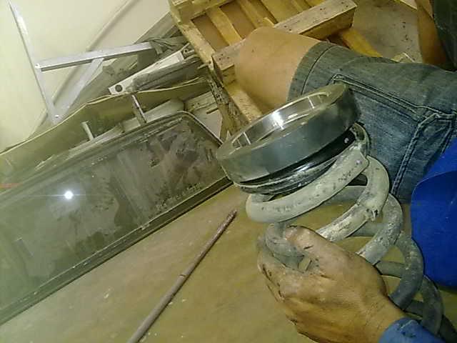

That's exactly what I did. Fitted a solid piece of steel on the back Coil. Nicely machined...And a rather ingenious spacer in the front.
The front shock bolts onto the spacer and then the spacer bolts onto the body.
