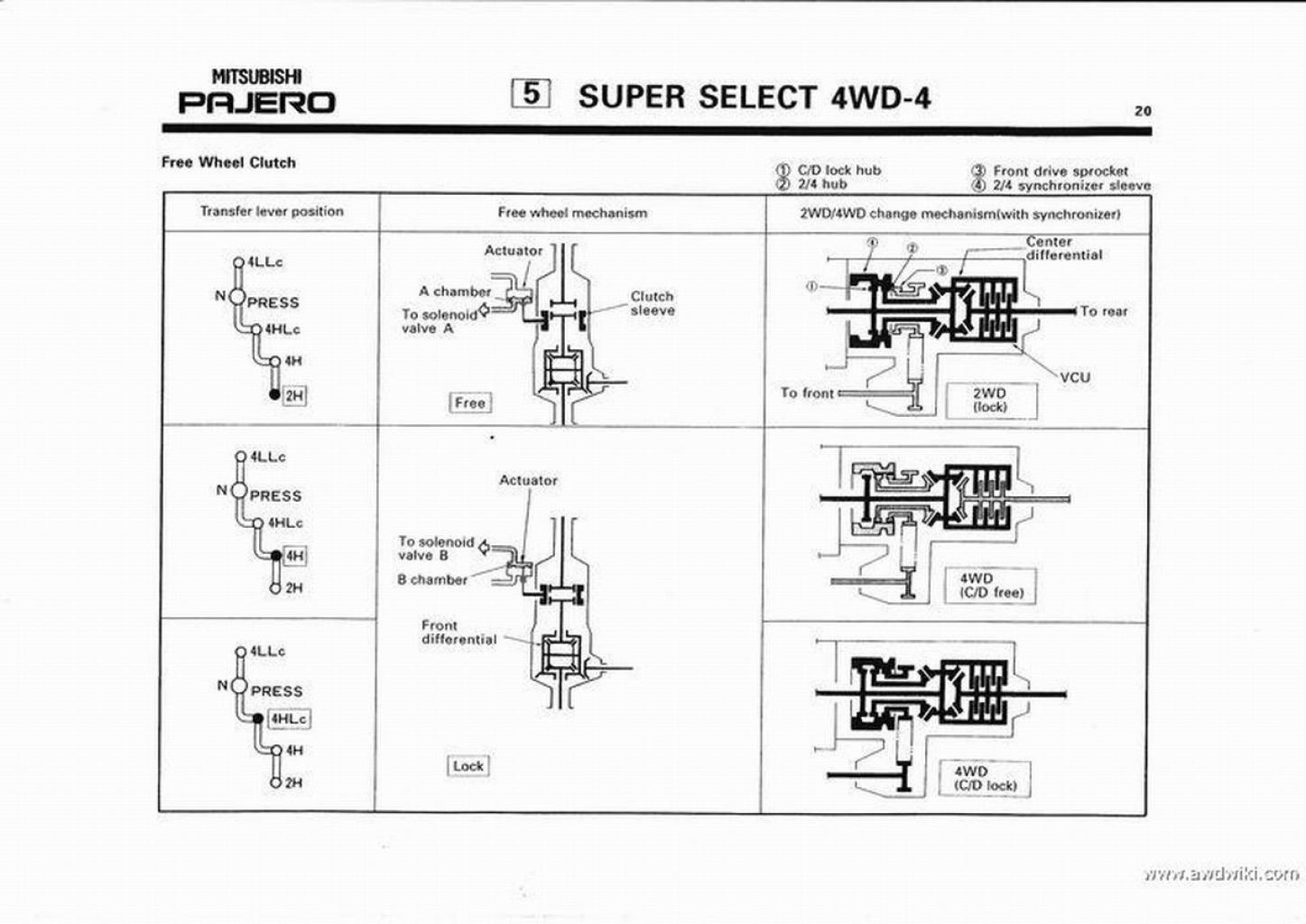

I have only picture of SuperSelect now: But definitely, I low this car as well

Selection 2H, 4H, 4HLc, N, 4LLc
