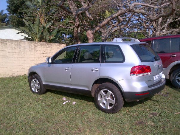

Damn straight! My pajero kicked the treg in the cylinder when it saw it was being traded in. Cost me a penny to sort that nonsense out!
