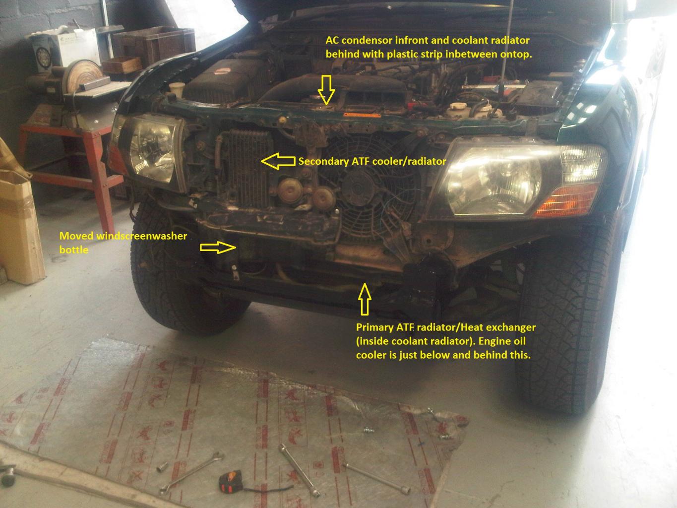

If you read the ARB marketing splurb they talk about having introduced a split pan design a couple of years ago and specifically comment that it provides "improved air flow". The gap between the upper and lower "pans" is above the winch slot - i.e. about where your number plate is on the Burnco bar.
It wouldn't surprise me if ARB needed to introduce that slot because of heat problems.
Of course, on my Paj, that's also exactly where the number plate is too, blocking most of the gap (duh). And even with a gaping hole where a winch would fit I am also not happy with temperature under load.
I need to take another look at an OEM Paj front end, but I am wondering if part of the problem is that the bottom of the 3rd party bars leaves a big hole from the bottom back of the bar to the front of the intercooler bash plate - so maybe fresh air entering what's left of the grille is pushed under the car rather that through the condenser / tranny cooler / radiator.
If that is the case then some kind of skirt between the bottom of the 3rd party bar and the front of the intercooler bash plate could help.
Any thoughts?

On the nudge-m bar just below the 3 lower holes is a piece of plate which faces forwards, I was of the opinion it was for strengthening that part of the bull bar, but it may have a function of forcing air through the lower 3 holes, almost like scooping it in.
I will give them a shout and see what the purpose of that is , if it is to force air flow or for structural strength at that point.
I haven't really noticed it on other bars, but I may be wrong. Will also ask for more detail on the washer bottle which is pertinent to this post.
David

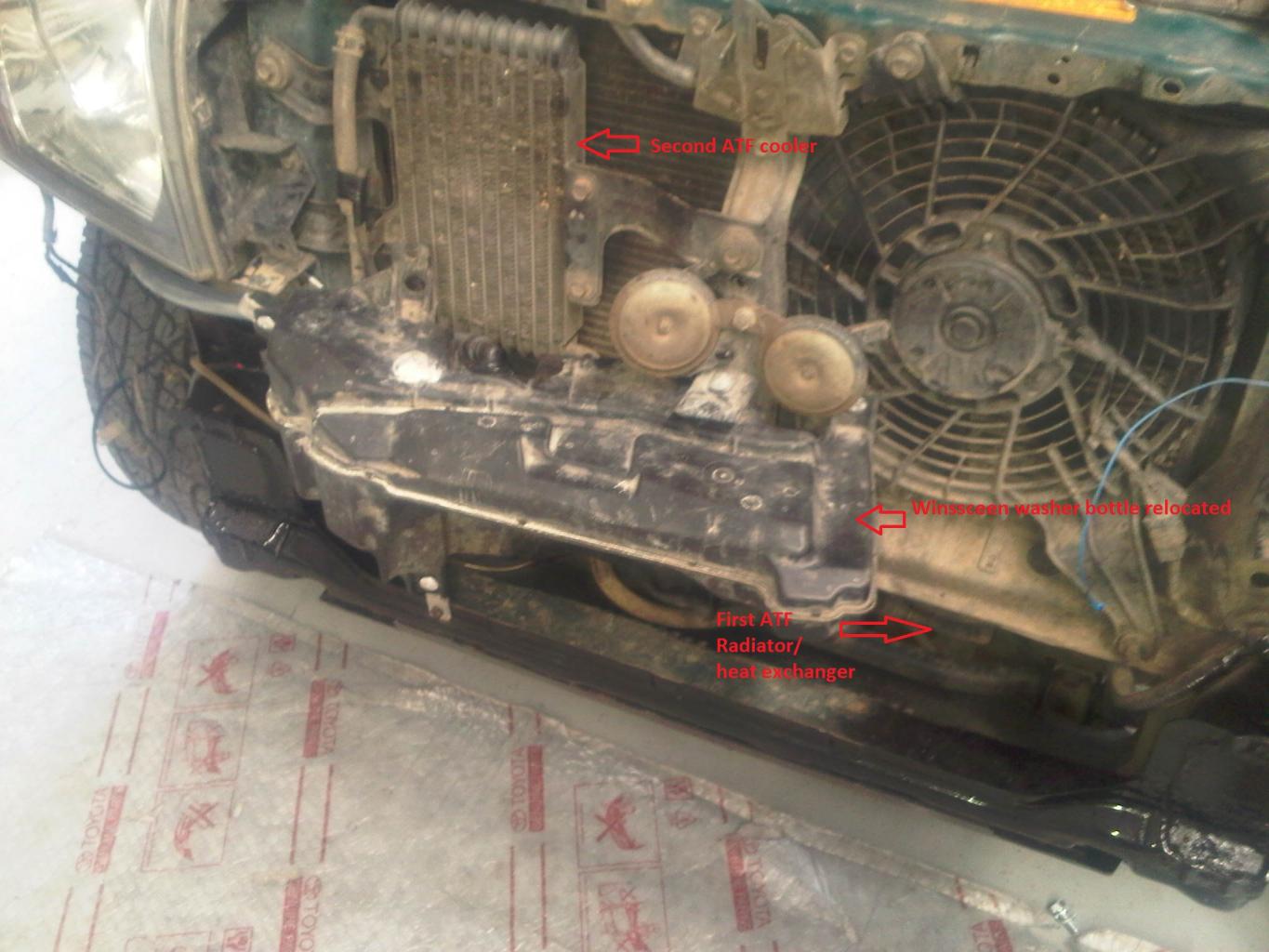

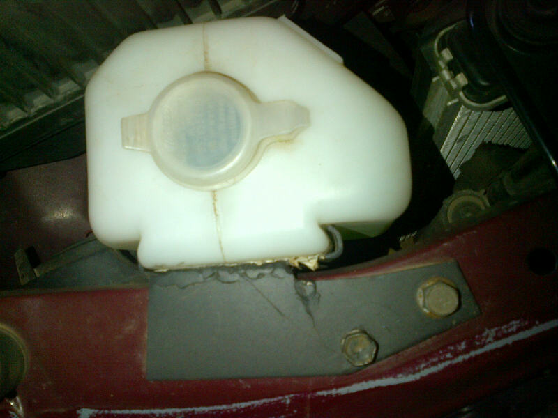

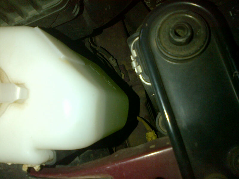

Re: Aftermarket bumper fitment headache
Here are two pics (again apologise for terrible cel-phone quality) to show how my bottle was moved to accommodate the bumper as per the OP question posed in his first post. I will be looking for a replacement bottle to mount elsewhere as mine is blocking too much airflow to my radiators for my liking.

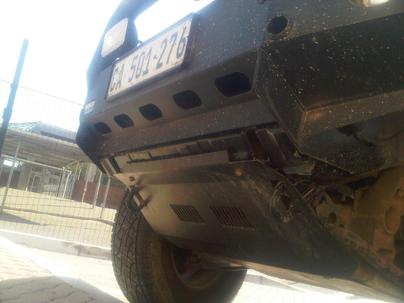

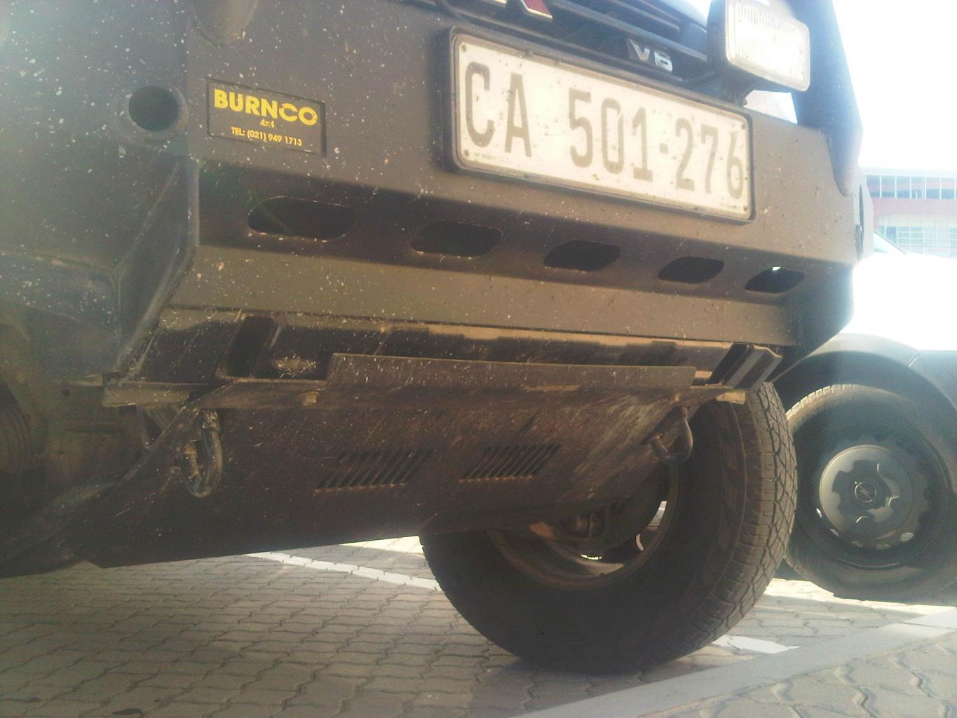

Hi Andrew
Here are some more terrible quality cel-phone pics I took of the 5 slots Burnco cut into my bumper, they are unfortunately at a slight angle to the road and not square to the airflow, but I am sure they will work better once my washer bottle is moved and I clean my radiators out too.
I am also not happy with the interface between my bash-plate and my bumper, it looks unfinished. I am going to make a new bash-plate which sorts this out at a later stage.

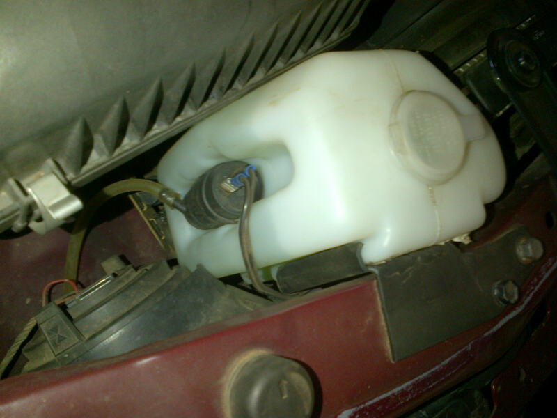

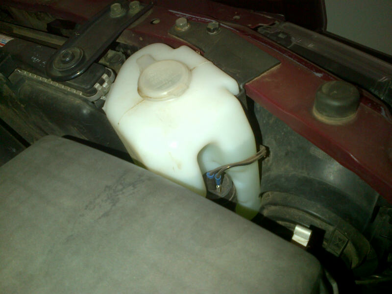

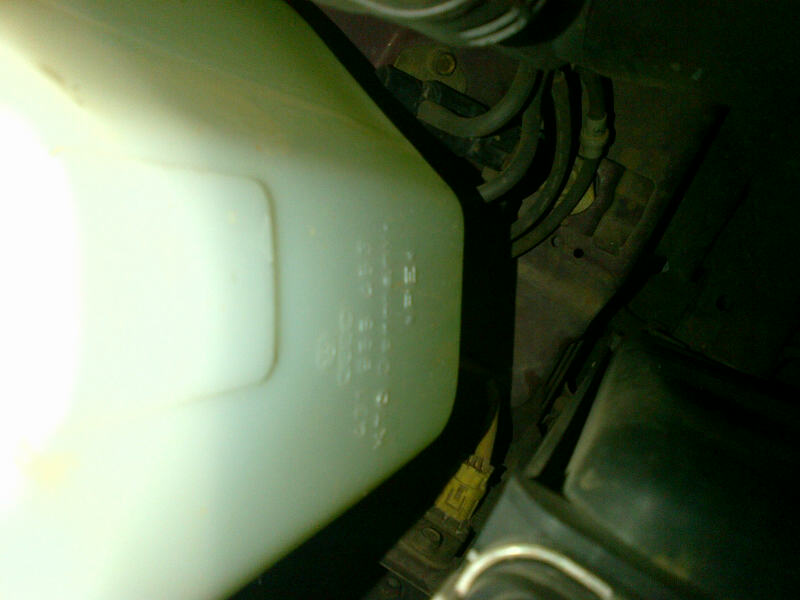

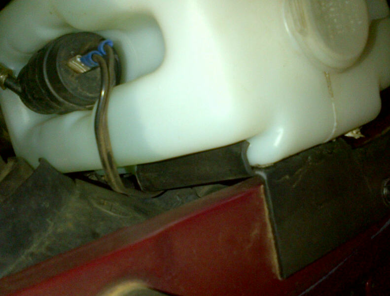

A few pics of my water washer bottle, it does appear that it is a VW/audi bottle, will get more details tomorrow from nudgem. The bracket is not very difficult using existing bolt points on top x 2 with a slide in type of holding mechanism onto the bottle.
The motor is on the side of the bottle and works well, the pipes all fit with no extensions required, just cut to length,only gripe is it is a little on the small side, just fill it up more often, takes about 2 litres, so OK with that.
