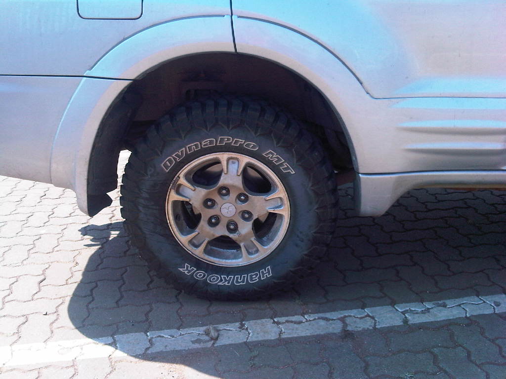

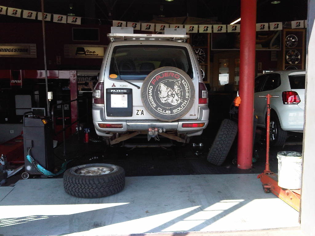

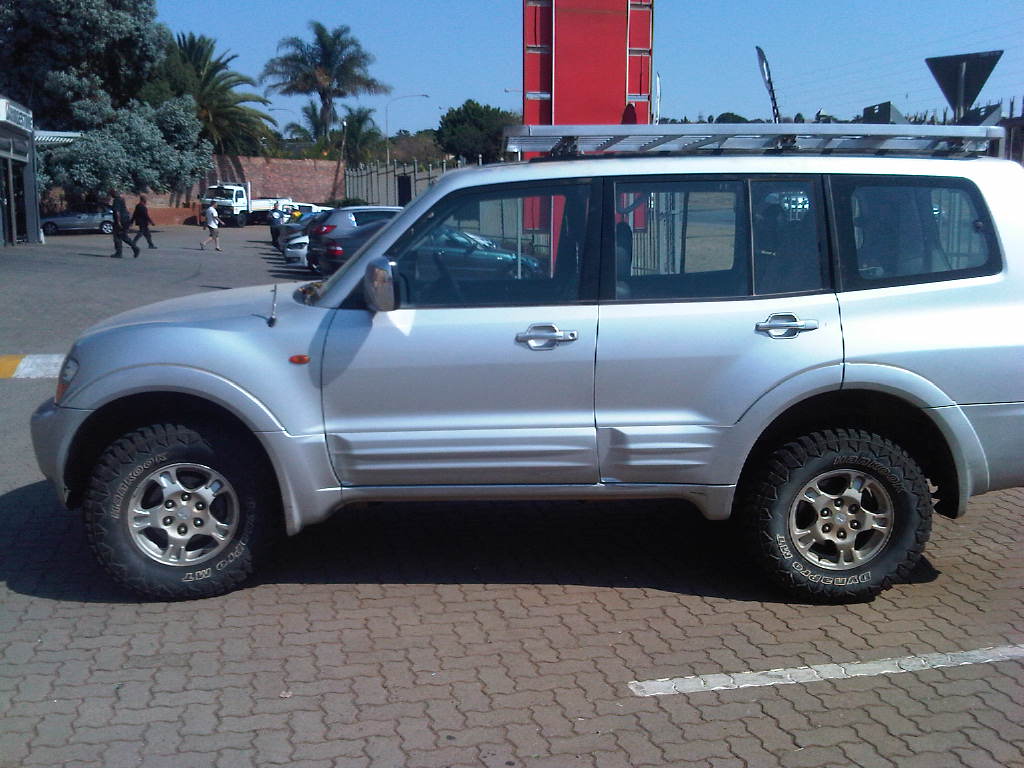

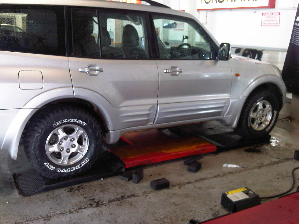

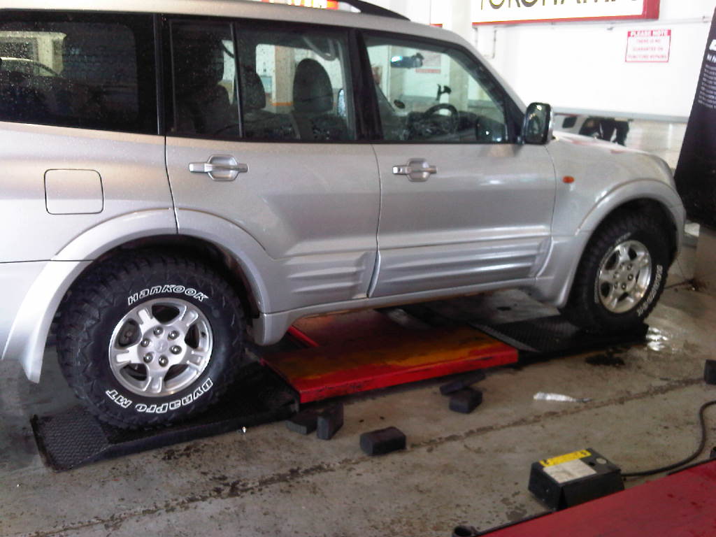

I had the spacers fitted on Saturday at Autouquip in Centiruion, took 4 hours but was neatly done. The owners reckon they do many of those a week. Some pictures before and after.
Teh ride feels very much similar as before, possibly less roll than before but on the main is the same. Drove back on highway from Pretoria to Roodepoort all smooth.

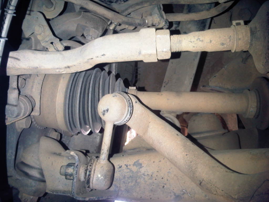

And before...
And before...

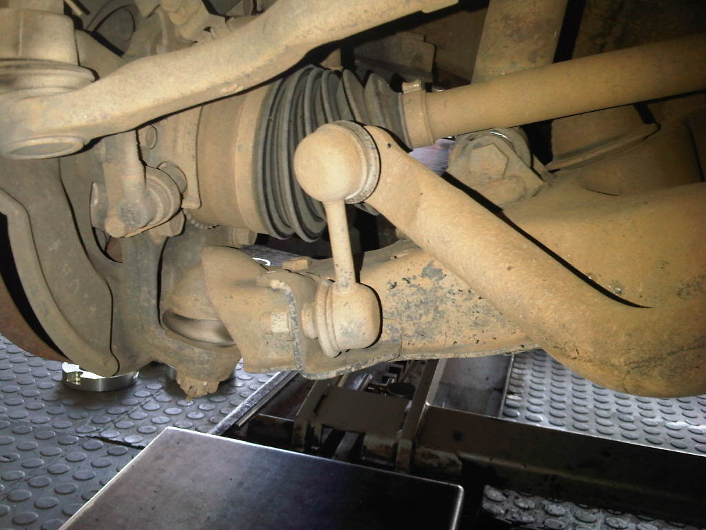

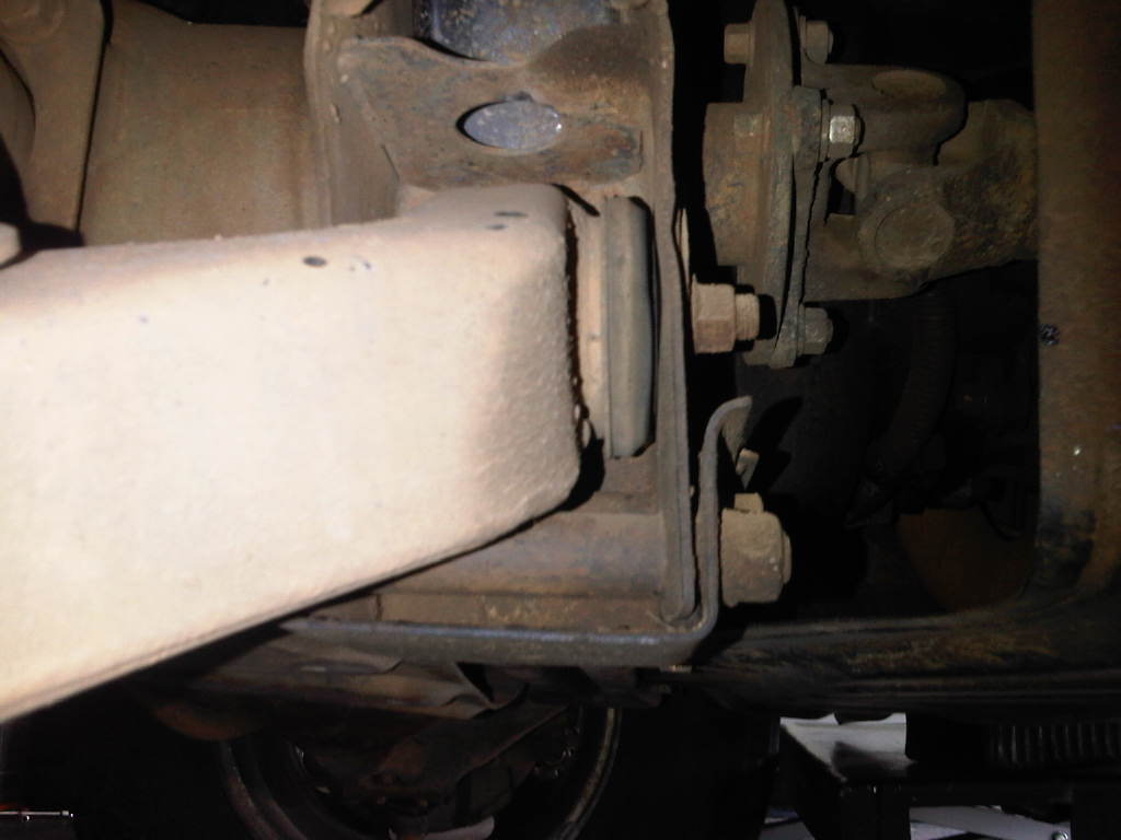

Arm bolt hanging free with wheel off, could get whoel finger in there
CV angle hanging free, top arm disconnected and bar not touching bottom bolt
4 hours in the stirrups

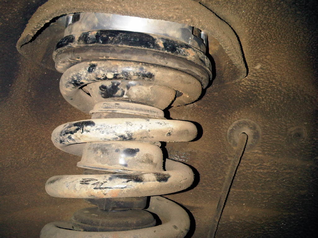

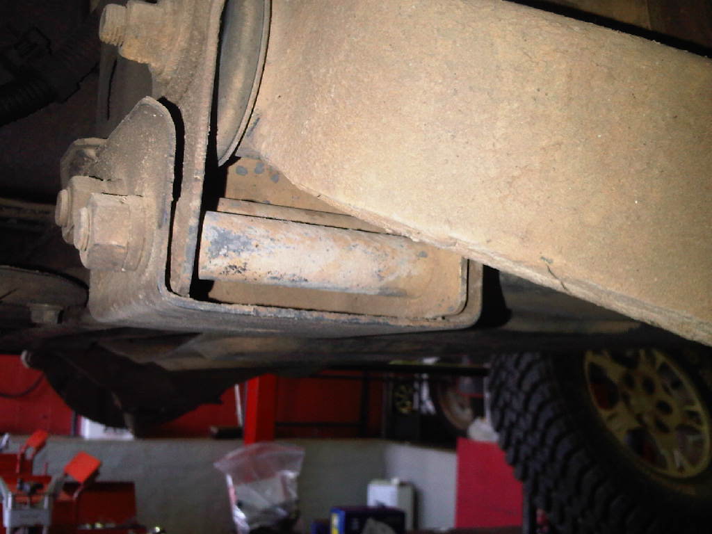

Spacer from bottom
Spacer from bottom
CV angle after fit and resting on wheel
After spacer fitted with wheel haning the arm was nto close to he bolt. Could still fit finger tip in there easily

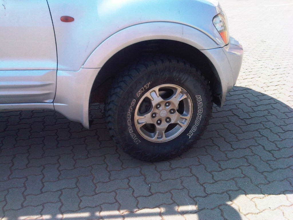

Front
Front
Back wheel little higher as front tried to keep the original ratio
Think looks very good and balanced, not too much just enough

Thanks David, very happy with it.
Yes the droop does not seem to be a problem.
I went for
Front set, 25mm spacer, 45mm lift
Rear set, 21mm spacer, 50mm lift
Measurements
Before
Front L = 701 Front R = 702
Rear L = 733 Rear R = 730
AFTER
Front L = 746 Front R = 747
Rear L = 783 Rear R = 780
Was measured from bottom of the rim to the wheel arch through the Mitsubishi badge. Might be a millimeter or two out. Forl old 2002 coils I think that is brilliant. :lol:

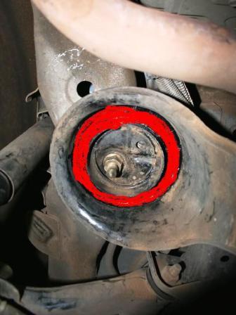

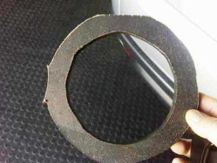

David after your PM,
This red circle is where the rubber spacer fits around, make sure it is cut correct ti fit around the cone tight, and that the surrounding "lip" will still keep the coil in place, Good luck
