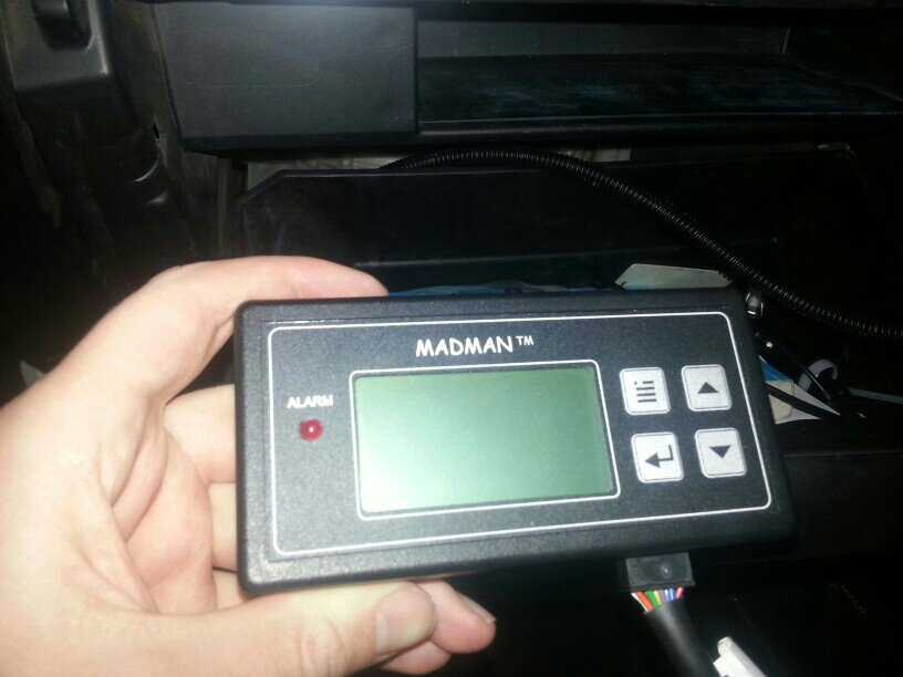

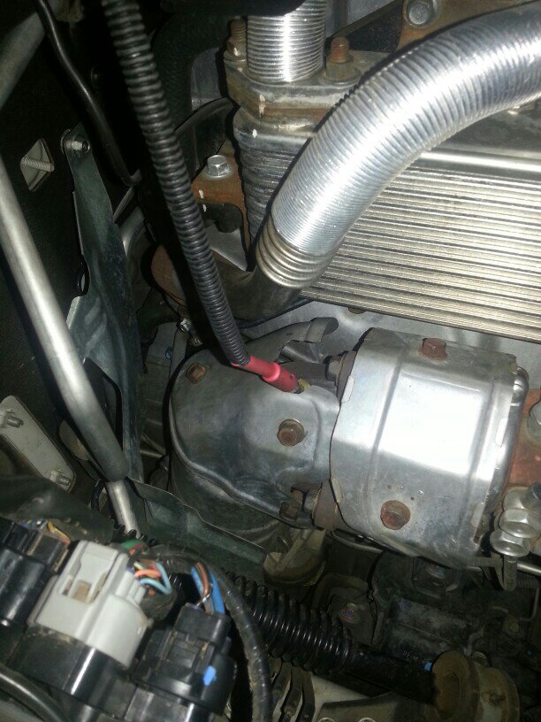

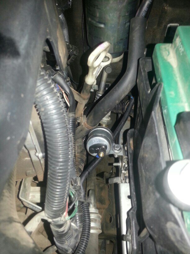

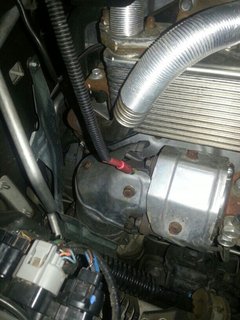

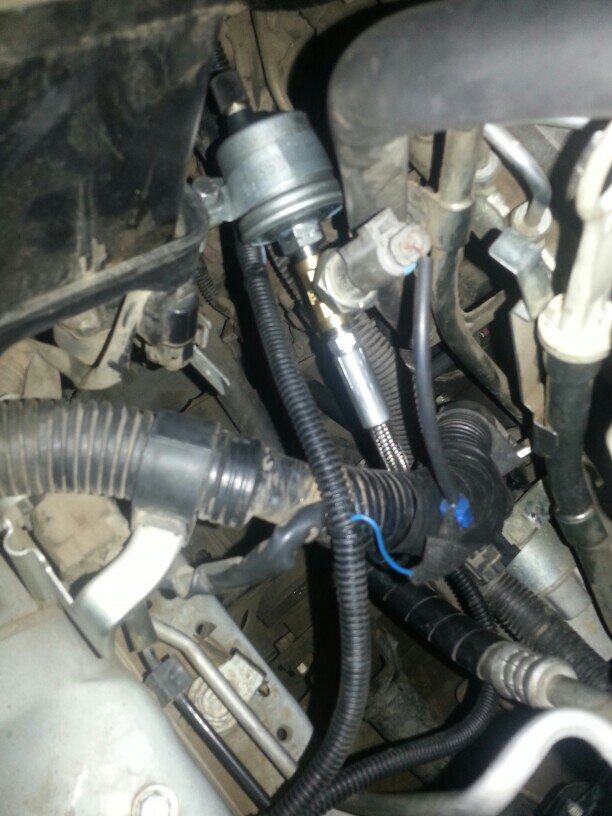

Wanted to do it at Mitspro, but when they asked for the wiring diagram I thought it best to install at the guys I bought it from - Landyonline.
I thought they did quite a neat job. Sensor for EGT is however installed post turbo, so readings are about 100degC less, but Sho - can't believe how sensitive they are to drive style.
Also noticed, it takes quite a while for the EGT temp to go below 200degC, when stationary before switching off. Anyone know the rule of thumb for ideal temp before turning off?
I also now get oil temp pressure and temp, as well as coolant temp.
The EMS 1 is fitted to my cubby hole with enough length for me to take it out and hold it from the driver side.
