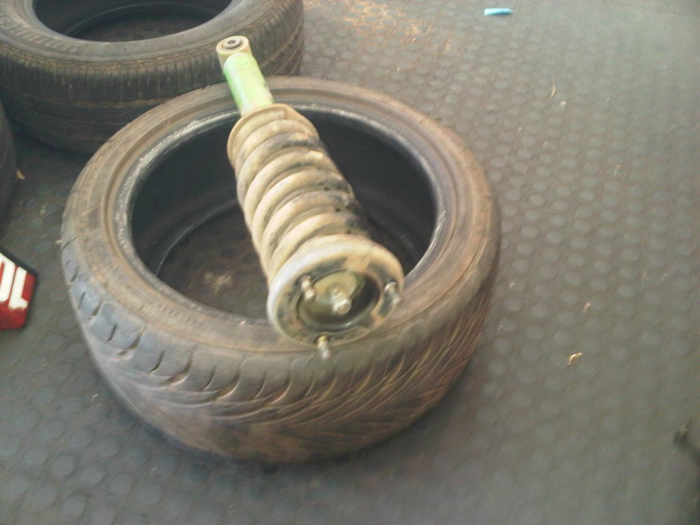

Just an long overdue update on my HDP rattle on the front axle saga.
After getting hold of the rep for the durbanville area, I went to her prefered workshop, supa quick in wellington road. Turns out both my front shock had siezed somehow... This is after replacing stabilizer links and bushes, upper ball joints, and going to DEKRA for a suspension test to rule out suspensuion issues. Dekra refused to charge me for the test as they could not find any play in my suspension....
I am sitting here waiting for the warrantee replacements, will revert once new one are in and have driven them for a day or two. Holding thumbs.

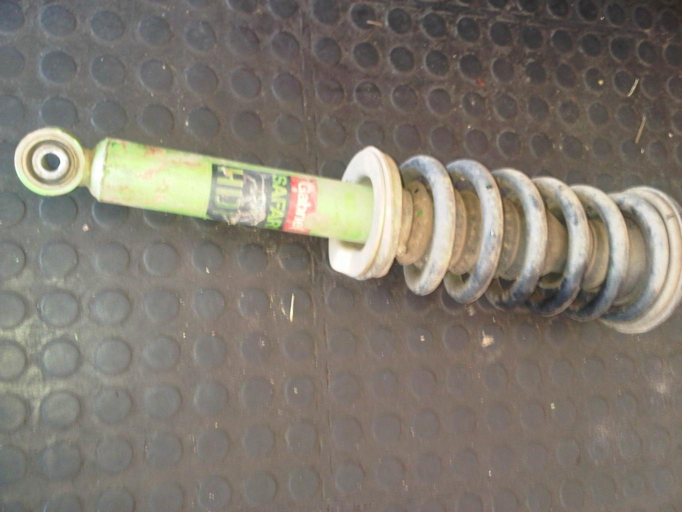

Problem solved!!! Eventually Pedro has lost his irritating clunk when going over corrugations or bumps in the road.
I had a look at the shocks (only 8 months and 18k km on them very little on gravel or off-road), both were stuffed, left front more so. The left one where the noise had come from had "rough/tighter" section in the bore (did not push in smoothly) as you pushed them in, and at a certain point just dropped 25mm with no resistance with just my weight on it
