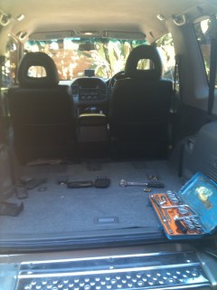

by Skillie
Thank you Roelf
I removed the arm rests as well.
Who said a Shorty doesn't have boot space?
Plenty of boot space!
