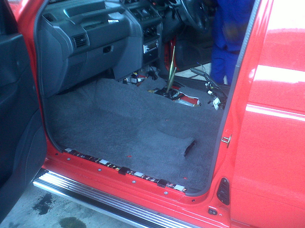

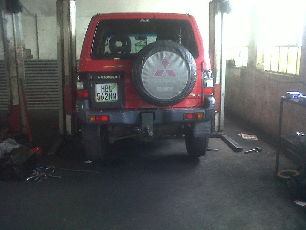

I just sorted it yesterday it was caused by wrong wiring by the previous owner when they fixed the gearbox few years back, it had wiring brace cut no idea why but I’m told it was to try and make the system function and a broken switch on the gearbox. From this ordeal I have learned that if the super select lights don’t work there is definitely something wrong. I have spoken to other owners that leave a 40rand globe fix were it could be something serious. Rather spend the day and fix it as it is a diagnostic system to show that everything is in working order. In my case repaired disk brakes but still had a slight shutter when breaking . On Tuesday I bleeded the breaks and found that to be a bit old, filler cap seal was installed backwards and one wheel with decreased thread in comparison. Then decided to take it in to a auto electrical shop in Rustenburg were 2 other pajero’s but gen3 stood with the same type of problem on the selector system. I had troubleshooted as much as I could on my own following a guide and found that valves are working but not engaging thus auto electrician. They replaced on bulb one switch on the gearbox (modded gen 3 switch) and re wired the brace correctly. This has improved drive comfort and removed the shutter caused by front left wheel engaging randomly(error from ecu wrong input values). The diff lock works and low range actually feels like a low range. Now I can proudly say its standard, fixed and running great for only 1500rand and a bit of student discount 
