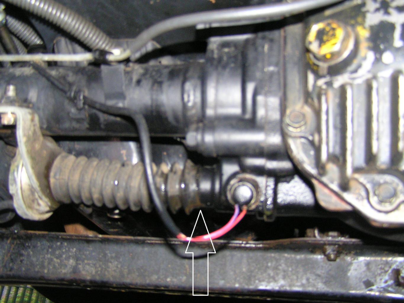

Hi Everybody,
My Pajero (2003 LWB 3.2 DID GLS) developed a leak on the front differential :( . The arrow on the attached photo indicates the position where the oil is dripping out. I would like to know the procedure to replace the oil seal (I suppose the will be a seal) round the shaft operated by the servo pump.

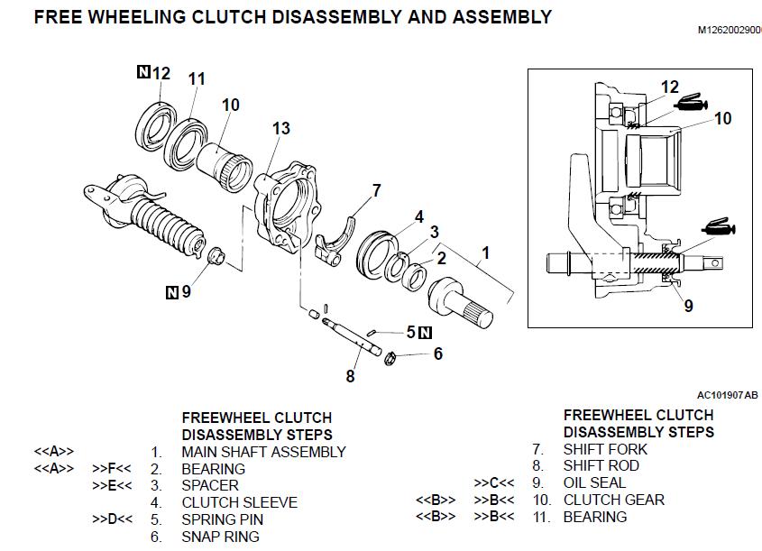

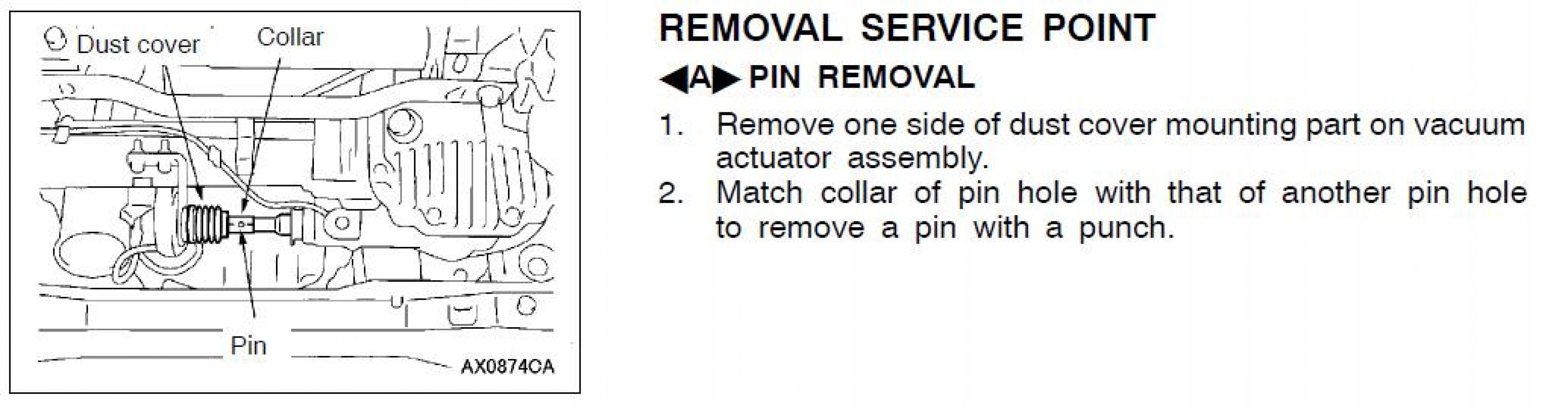

Maybe this helps..

Is there further instructions in that manual on how to replace the seal?

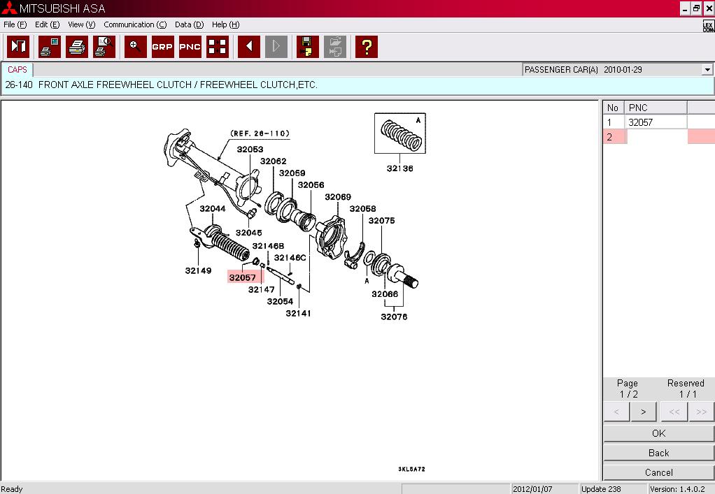

Re: Front Differential Oil Leak - Please Help
Thank you Marius. Please explain why the part number is not the same as the number on the diagram.
Ehank you Gerhard. Same question as Marius. Do they tell you how to replace the seal?
Regards,
Waldo Fourie
bold4E wrote:Thank you Marius. Please explain why the part number is not the same as the number on the diagram.
The number on the image is the PNC number (Parts Name Code)
It denominates what part it is but certain vehicles have different part numbers with the same PNC
Example - The front springs for the gen3 diesel and petrol will have the same PNC but different part numbers as they have different load ratings.

Do you know what that seal looks like? Ain't it just a normal oil sael?
Waldo Fourie
it looks like a normal oil seal but in the middle of the seal is a copper sleeve.
