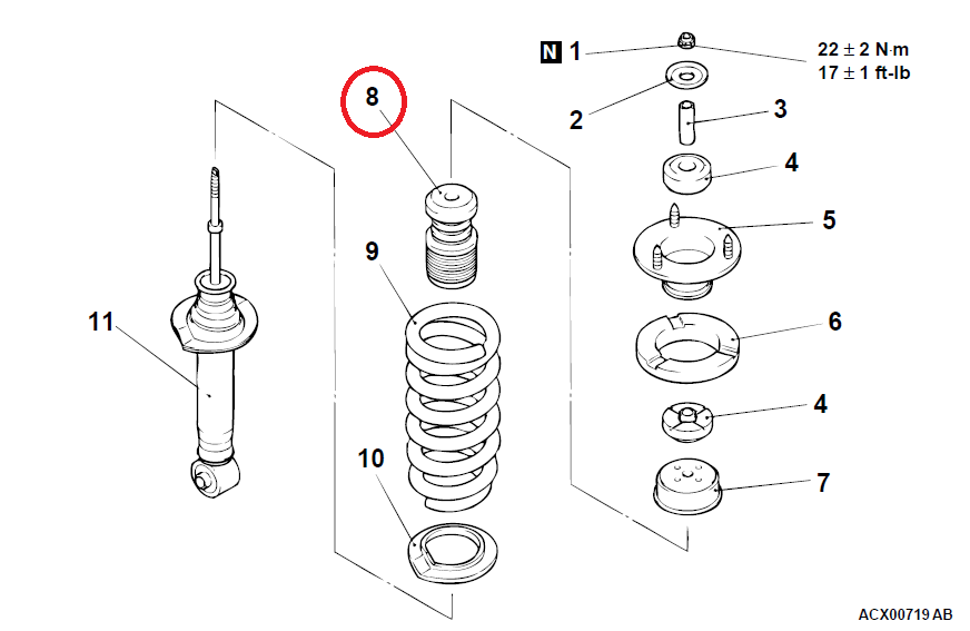

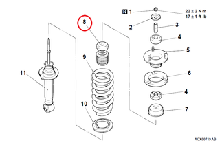

Hi I also had problems with my HDP shocks, one front one collapsed on the vehicle and they replaced both.
There is a rubber fitting which fits on the top of the shock, it comes with the vehicle -See the item 8 on the diagram, did they fit this with the new shocks??
There are all sorts of cups, washers and rubbers that are to be reused when you change the shocks, btw who and where did the fitment?? Maybe they are to blame, Control Instrument really came to the party to sort my warranty claim out, I originally used a tyre fitment centre who did to have much experience with fitting shocks, they recommended Supa-kwik in Durbanville who did the swap out

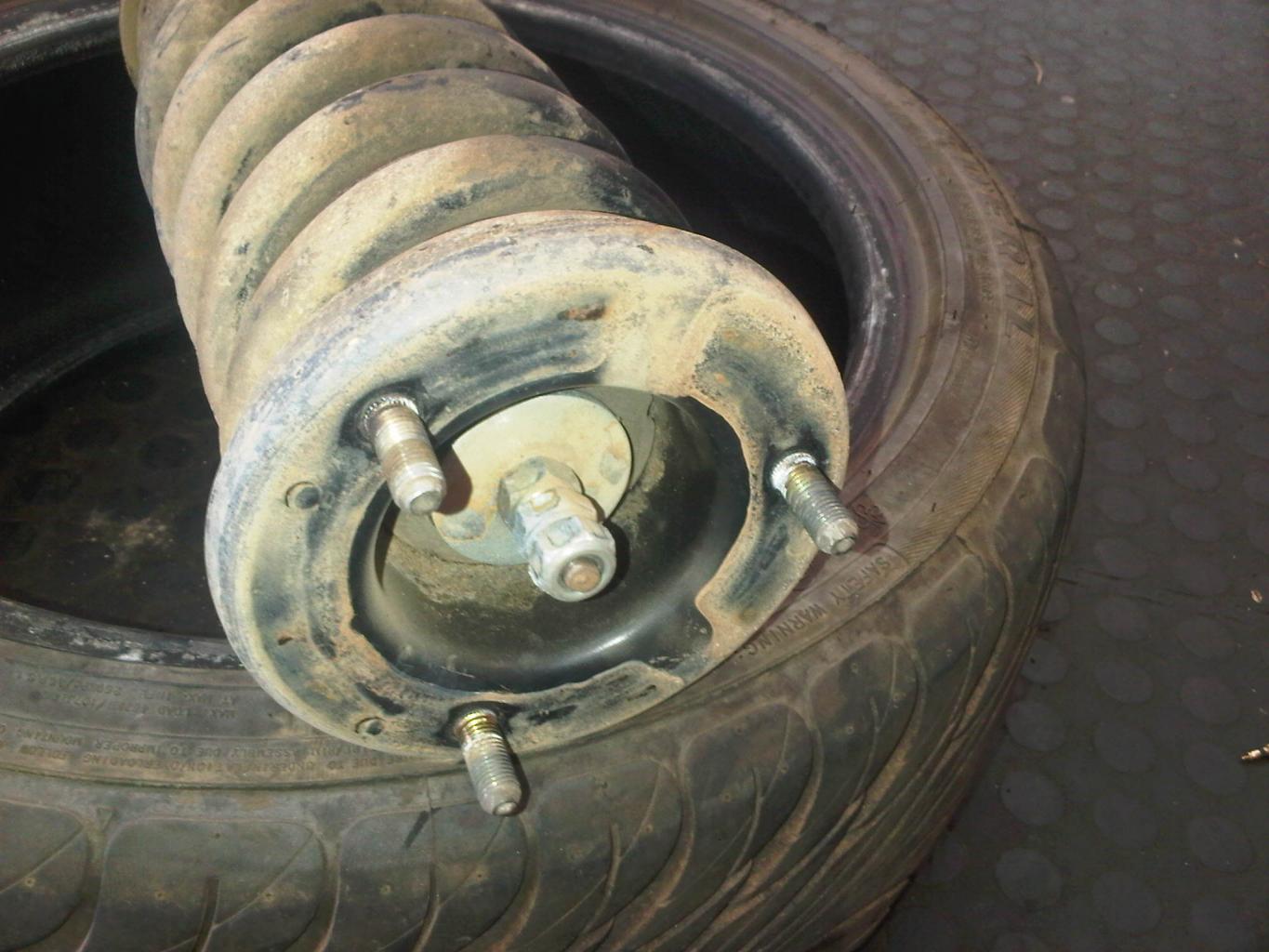

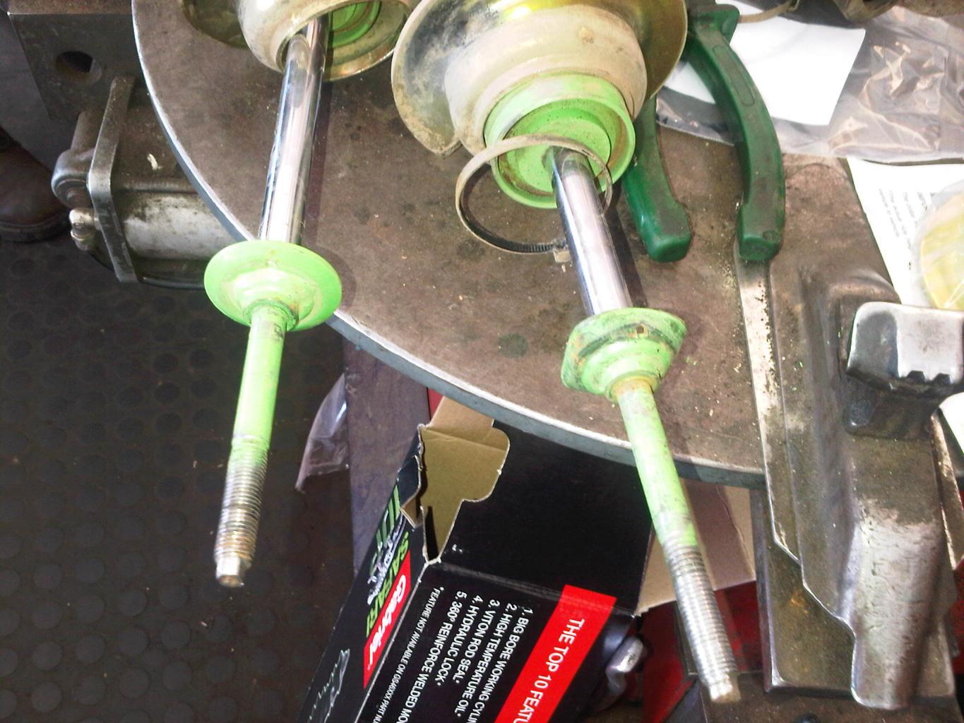

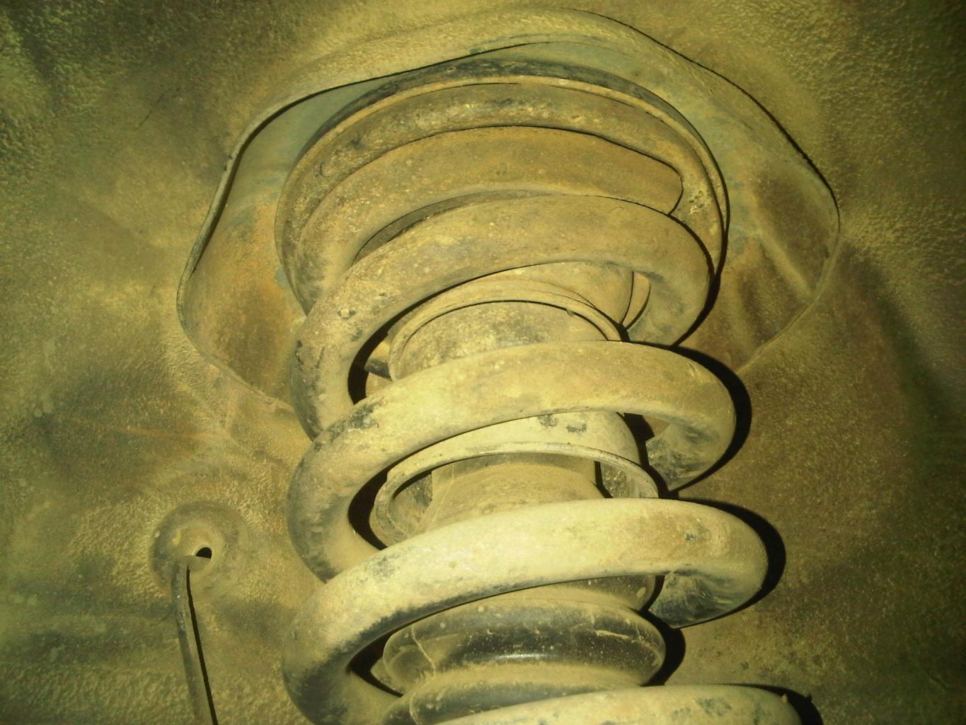

Here are some pics I took of my shock/coil assemble when they replaced mine.
Also see my posts of my issues in this thread:

Re: Gabriel HDP Issue
Hi Nick thanks for the reply, the lower spring mount on my vehicle is different to the one in your Pic. I don't know if it's possible but I have a suspicion this vehicle may have been fitted with a BK font suspension. The lower spring cup looks different and is tapered and narrow, compared to what you have in your sketch. The threaded section and mounting washer welded to the shock simply does not fit through the spring cup. The guys that fitted the shocks are next to a 4x4 accessories dealer and install all their aftermarket stuff in fact they reported back to me that the shocks didn't fit after only an hour (and had already fitted the rear ones). They undoubtedly know their way around a Pajero and even checked the ball joints and all the Bushes. I am confident that they assembled correctly and did a good job.

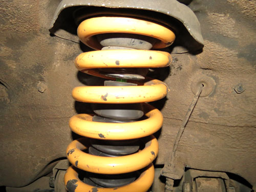

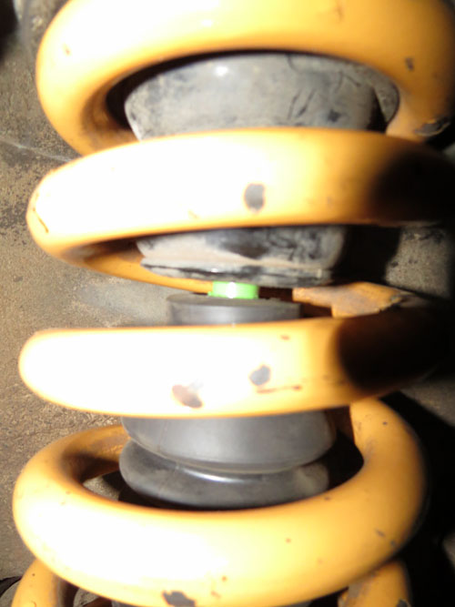

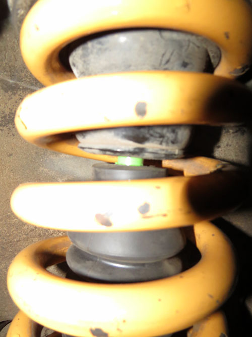

Hi Nick,
I had the same shocks installed today, but I am almost certain they left out number 8 as you've pointed out. Now, I have a knock sound at the front passenger side if you drive over an uneven road surface. I took off the wheel and checked everyhting i could think of, but found nothing.
Is it possible that you can take a photo of the top of the spring/shock where this part should be?
I have a gap of about 10mm between the shock boot ( the part that is bent on your photo) and the metal cup ( part of the oem stuff carried over), where you can see the green paint of the shock. I am almost certain it is causing the noise.

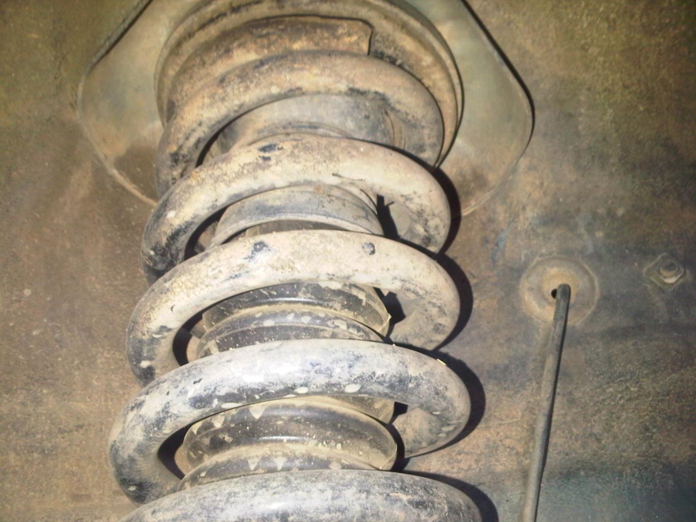

I took some pictures!
and
Does yours look the same?

Hi Drone
Here are my pics,
looks like you are missing something - too much of your shock is showing, the rubber boot/dust cover of my HDP is within the part listed as #7?? Not having this part could lead to excess play on the upper shock mount and will lead to clunking when hitting bumps. Is your shock tightened all the way on nut on to the top??
Ps. Is that a TJM coil, it looks quite thick with fewer turns than OEM coil, must be quite a hard ride??

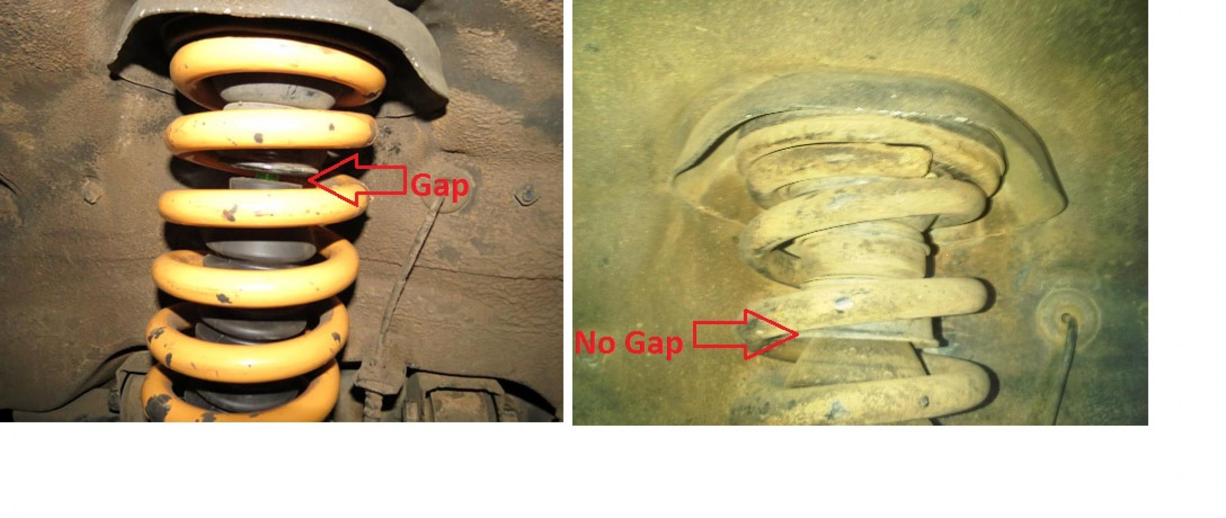

See comparison between setups.
#8 in diagram is a rubber bump-stop with a dust cover attached for the OEM shocks, it is not re-used on the HDP shocks. Looks like you are missing Part # 7 on the diagram...

Hi Nick
Thank you for the photo's!
I know #7 is there, but it is turned upside down on mine. The cup side is directed upwards. That will be the reasons for seeing the exposed shock rod then!
I checked all the bolts, no issues there. What I will do is buy a spring compressor and take it apart myself to check if everything is in the correct order.
I took the standard coils back with me, so if I need to, I can put them back to confirm. I left the standard shocks there unfortunately, otherwise it would have been easy to see if it was the shocks :?
The coils are Ironman, I bought from Gerrit here on the forum. I am also pleasantly surprised by the ride! It's not hard at all, a lot firmer, but not unpleasant. No more body roll or nose diving. The corrugations I drove were soaked up with much more ease than the Standard Coils and shocks did! BUT I must add - I have no idea how old the shocks were.

Hi Drone
I am not sure if the way the suspension setup works/fits together allows you to invert #7, it needs to face down as the upper element is too big for the cup to fit over - don't know if I am making sense??

I have now had the original springs put back in and I took the diagram you posted with so they can put everything in the right order. But no luck. The clunk sound is still there when you drive over uneven surfaces. But they do look identical to your photo's now.
