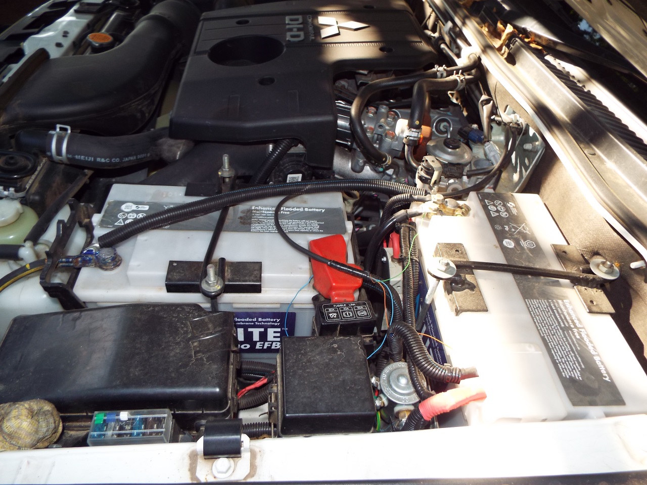

Hi John,
This is the dual setup that I did - I'll share my experiences on whatever you may need.
I built the tray, and then used a ColeHersee relay with an 85A DC circuit breaker to protect all the take offs except the winch.
PM for contact details etc (I'm in Kloof)
D
D
My and others experience is that getting a big 105 ah battery into the space for the second battery is difficult. It makes it a lot easier to fit the 105ah into the position of the main battery (the battery heat shield will not fit any longer though) and then fit the smaller main battery into the space of the second battery.
I share with Peterpot. Did exactly that. Did away with the heat shield but used the tray. I had to cut the tray away at the end to get the battery to fit.
Saved myself a lot of PT and bought a Front Runner tray for R 450 from Ironman East Rand. Fitted easily. When the main battery goes I will fit a 90 Ah, should be a snug fit.
