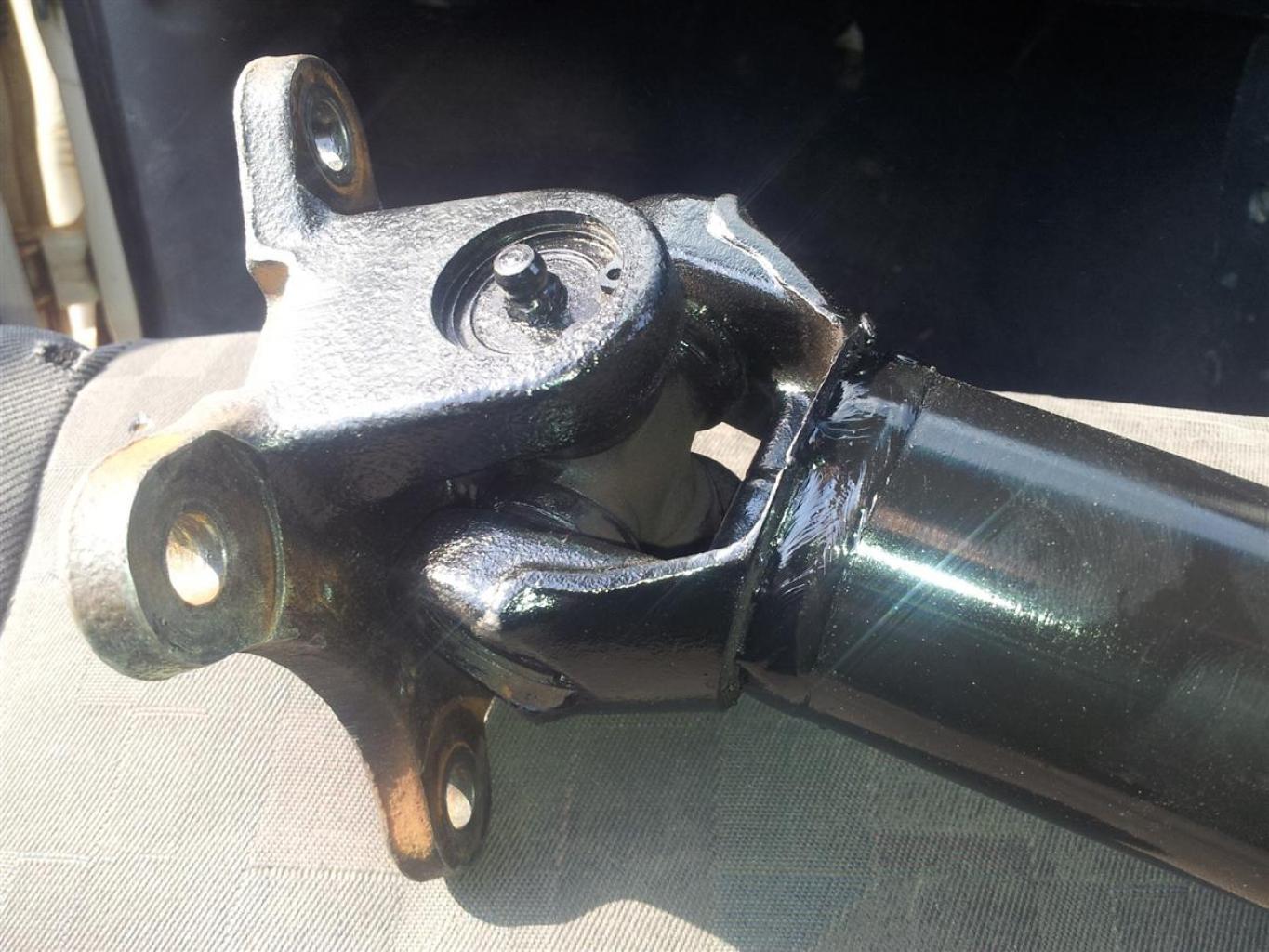

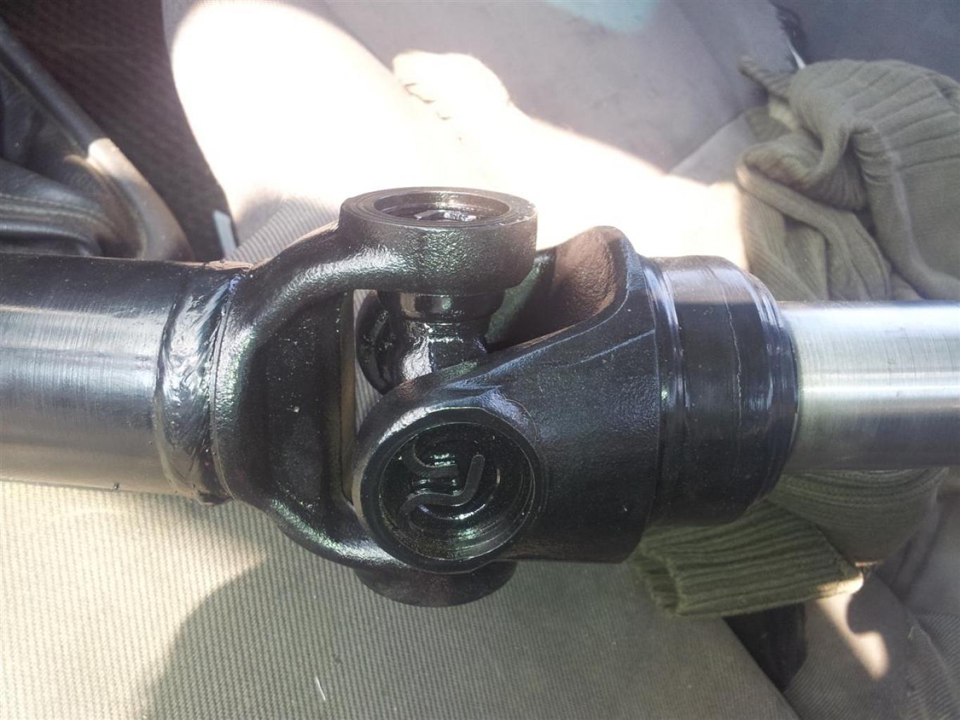

I asked Mr Propshaft to be honest and tell me how he feels about welding the yoke. He sounded confident of his CO2 welding and reports no comebacks to date. Paired with that and the auto torque converter acting as shock absorber, I gave Mr Propshaft the go-ahead to fix the shaft.
I don't have before pics but I'll post a pic of the refurbed shaft once it's done.

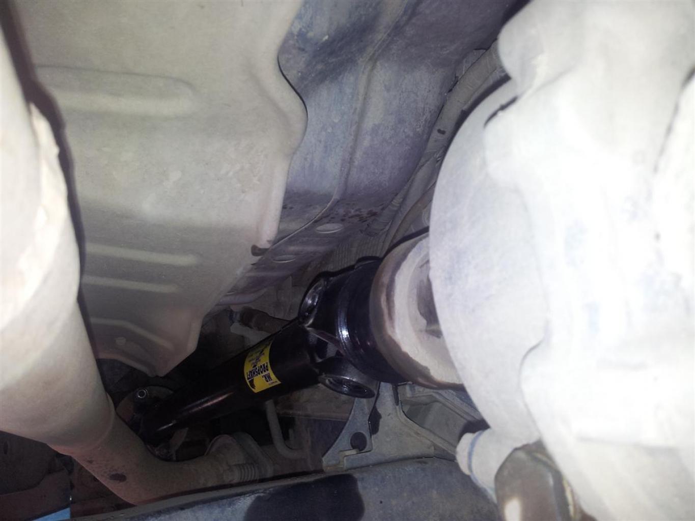

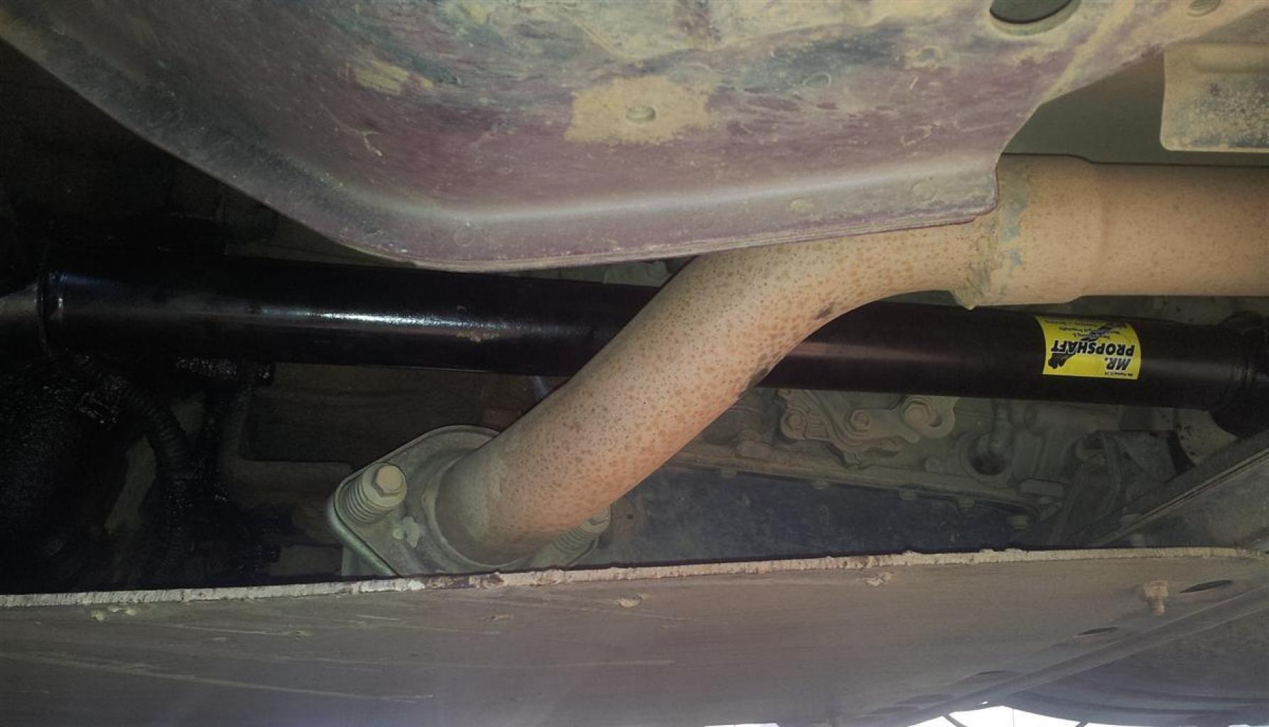

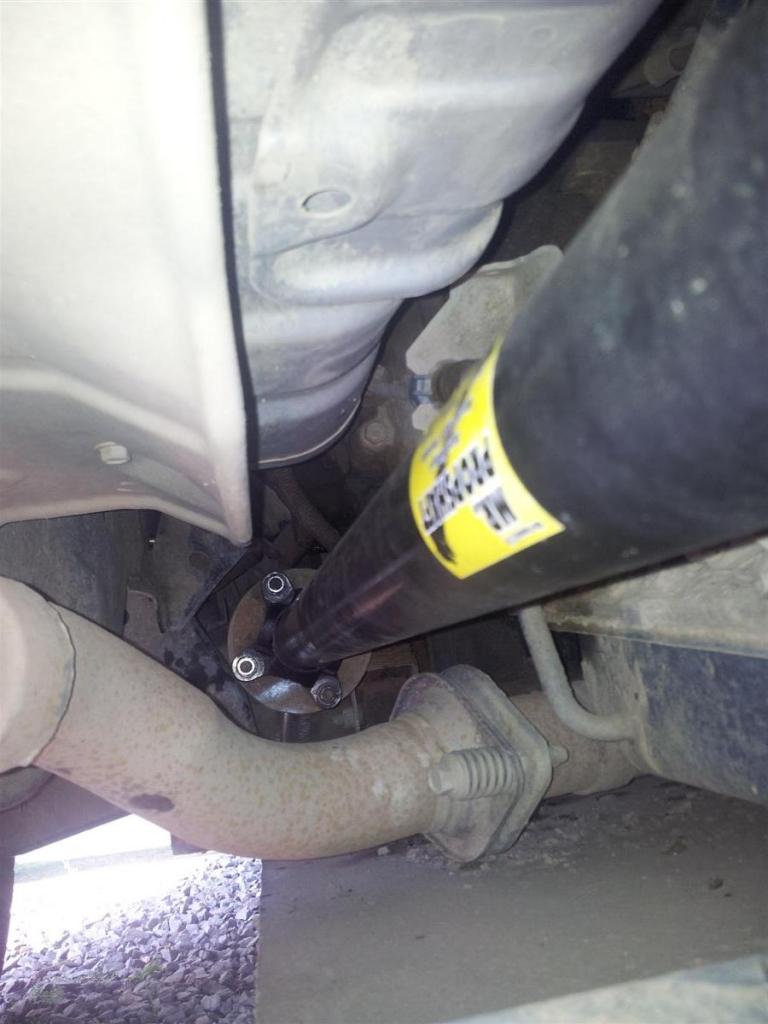

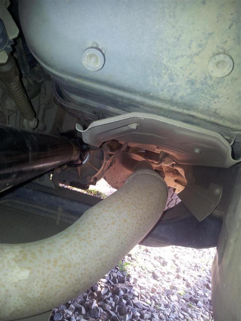

Propshaft in. New Easyshift GL-4 in the transfer case.
Click click gone!
Click click gone!

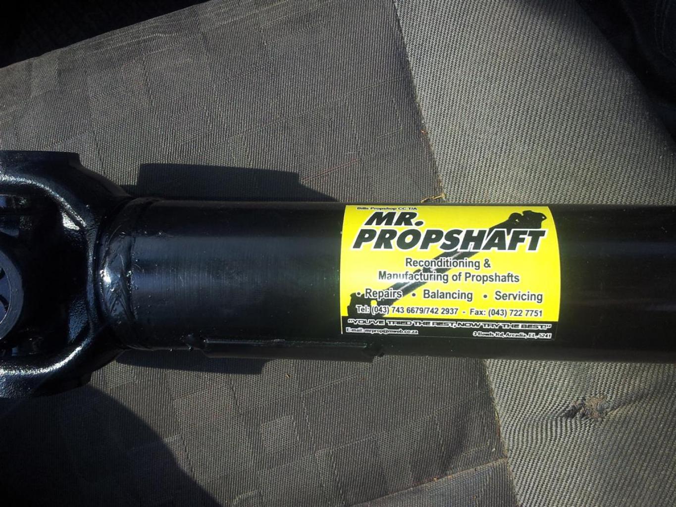

All in R2223 for cutting out the CV, putting in a new UJ and servicing the existing UJ on the other end, plus balance, clean and paint.
In my opinion a good price for what seems like an outstanding job.

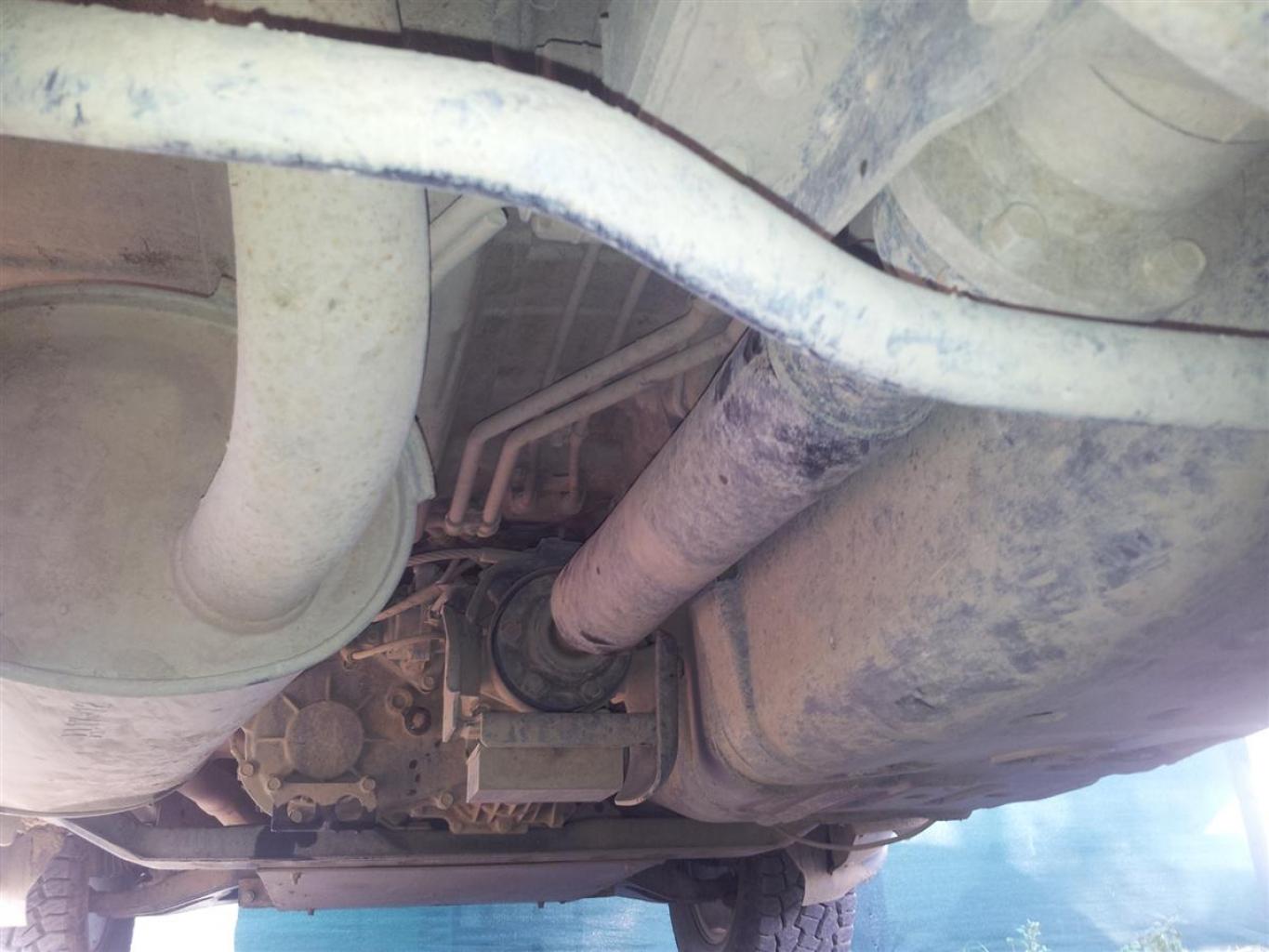

I'm just glad it wasn't the rear shaft that played up as that is a carbon fibre shaft and I would have had to ask Mr Propshaft to make me an entire new shaft of steel.

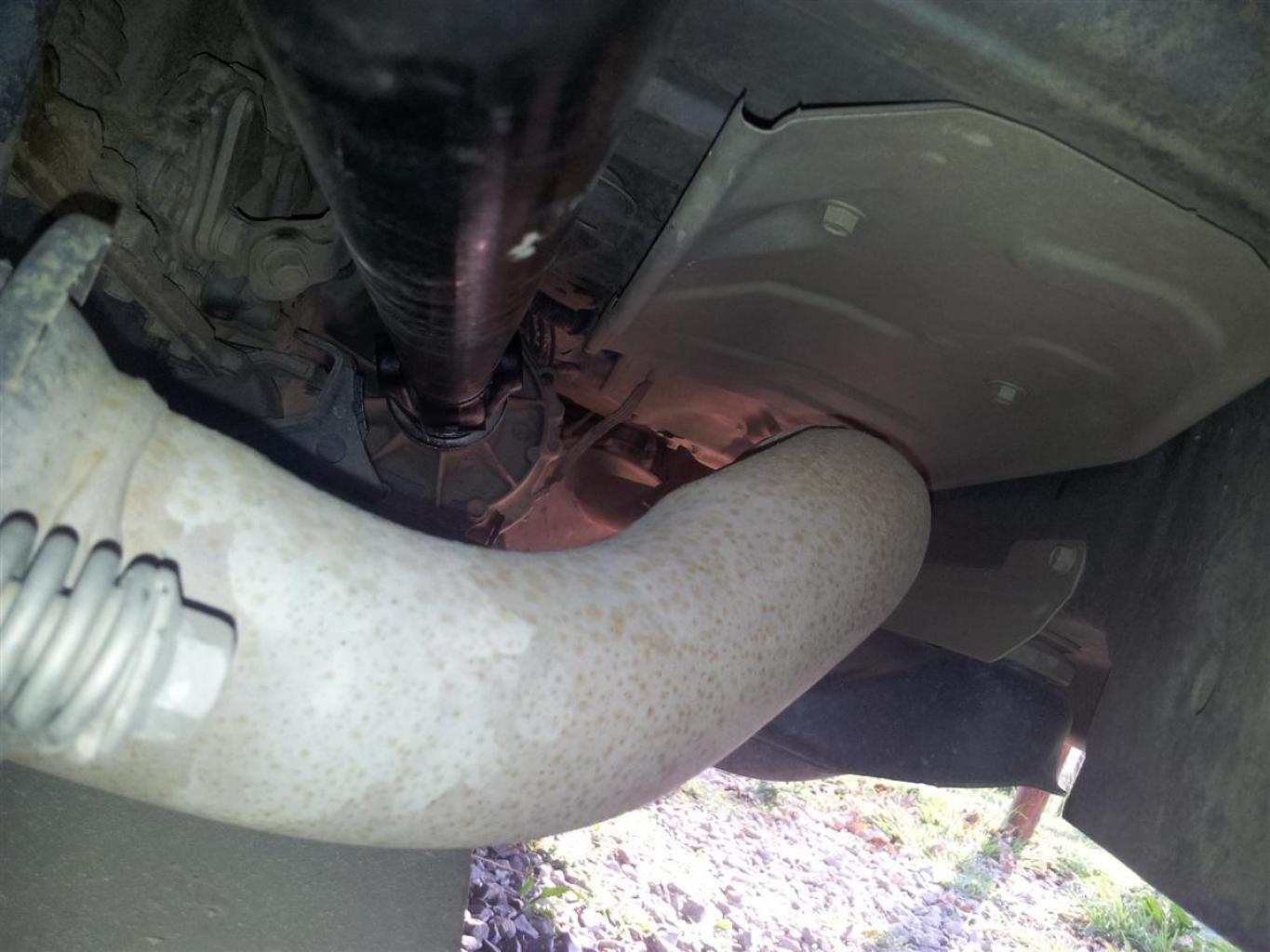

Some more pics attached.
