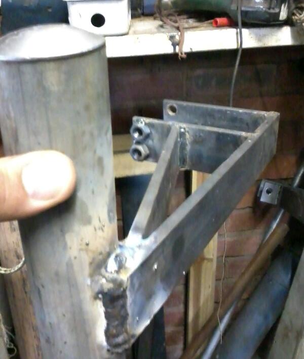

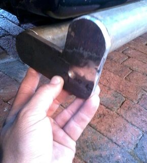

Having to panelbeat my excaliburs after each offoad trip I decided to build me some sliders.
The tubes are 50 mm x 5mm and the flatbar I used was 50 x 8 mm. And I used 10mm
high tenstile bolts to fatsten them.
They are strong enough to jack on and I putt recovery points on them aswell.
Here's the pics
The pipe with the chassis bracket

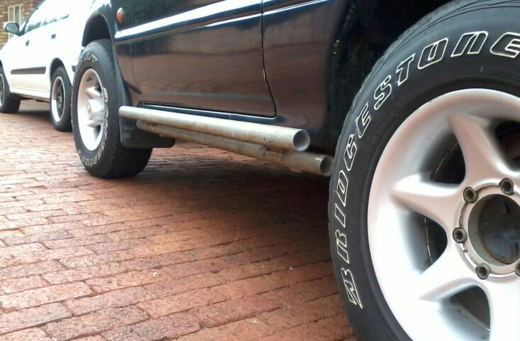

Slider test fit
Slider test fit

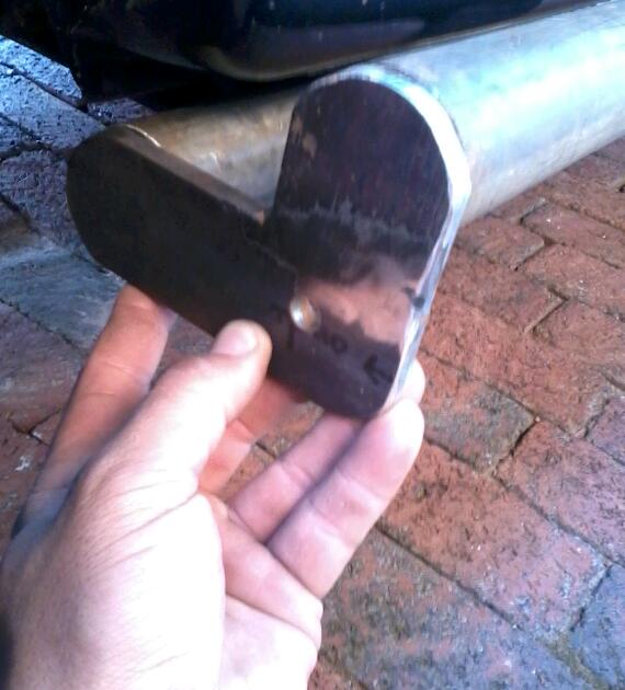

Recovery point planning

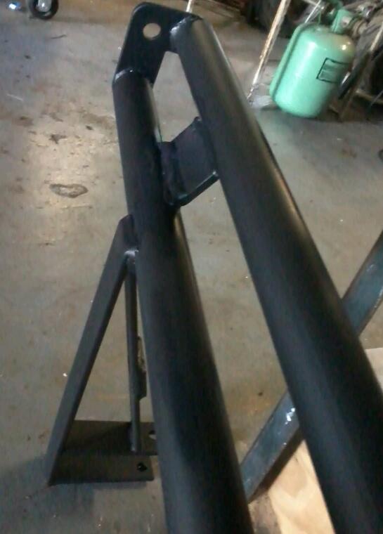

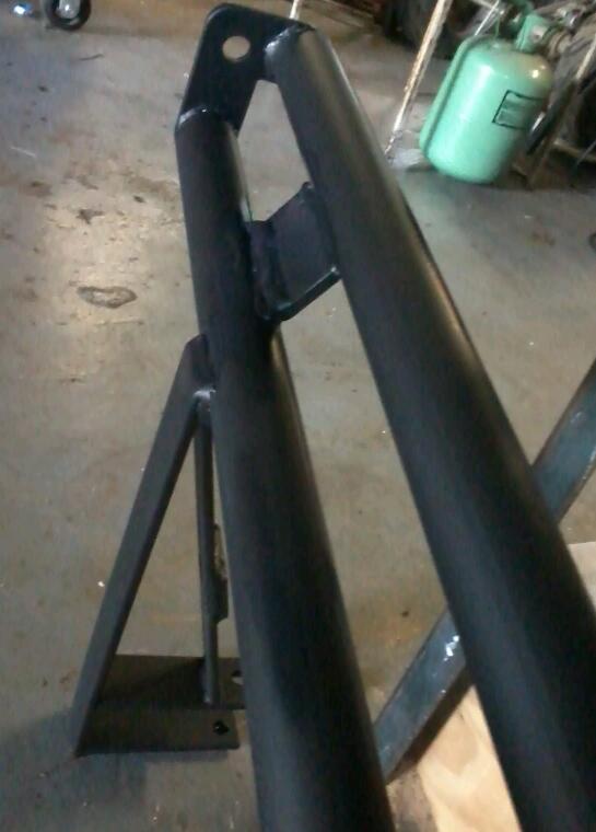

Primed
Primed

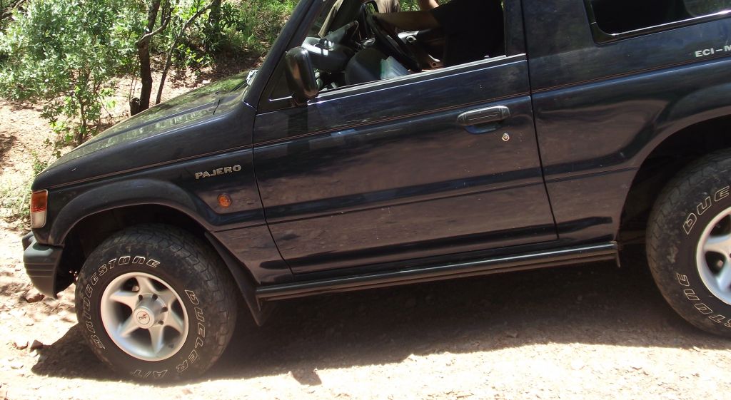

Finished
Finished

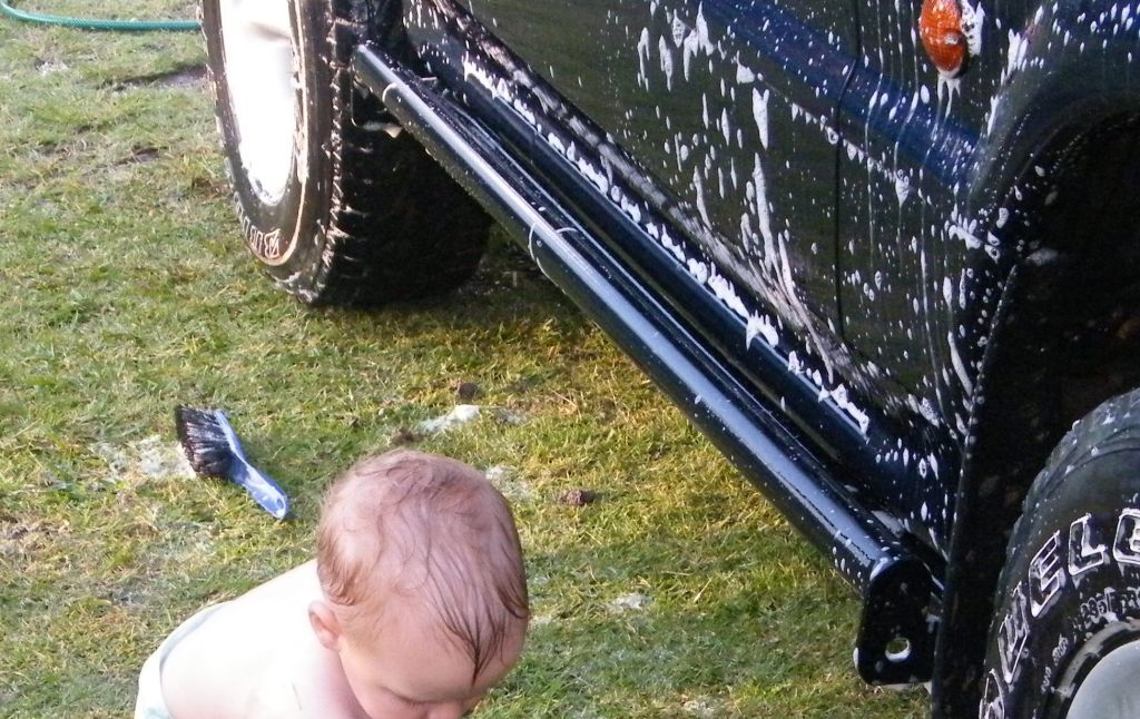

Finished and cleaned

Awesome job.Did you spray paint them yourself.What paint?
Henk
Re: Gen 2 swb rocksliders
Thanx JohnG
Yip I painted them myself,I used RB10 for a primer-its a water based primer. And for the top coat I used enamel-recommended by the local paint shop. But I reckon if you realy want it to be strong 2k would be the way to go.
Good looking addition congrats.
2K be a bit brittle for this application too much stones and chipping but Hamerite smooth is not as brittle and as bonus it has a potent rust inhibitor.
