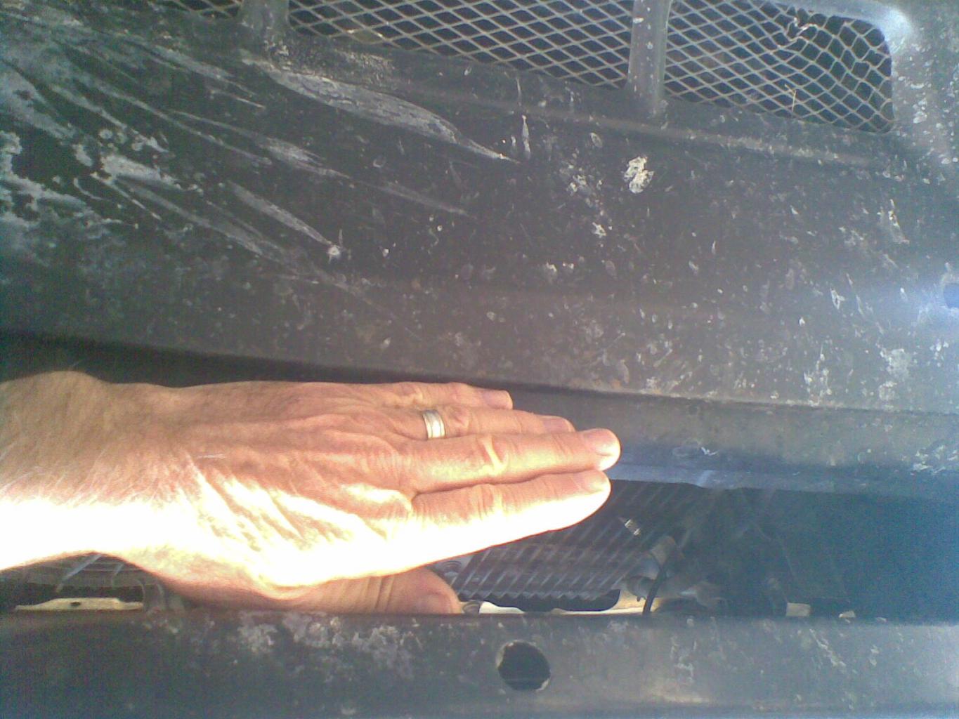

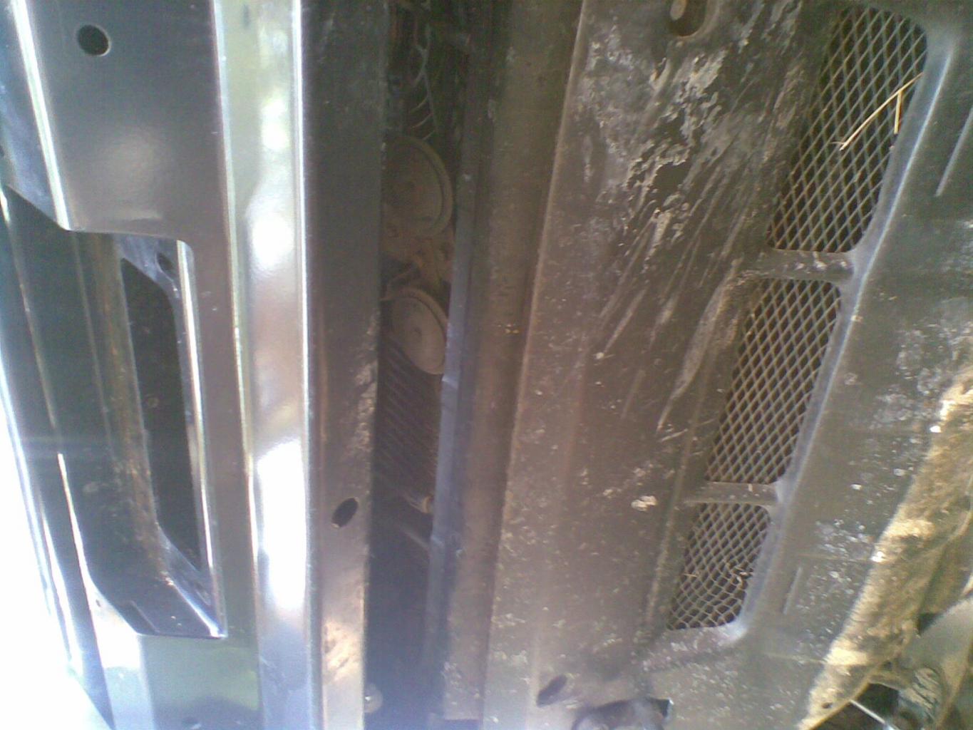

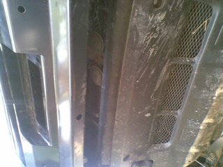

Not to be outdone, here are some even worse cell phone pics that show the gap below the ARB bar and the OEM front protector.
It's a handwidth - to help see how big it is I shoved my folded sunblind in the gap. I reckon a whole lot of useful cooling air can get lost through there.
View from below ARB bar fitted to Gen3.
There is a handswidth gap for cooling air to "leak" out

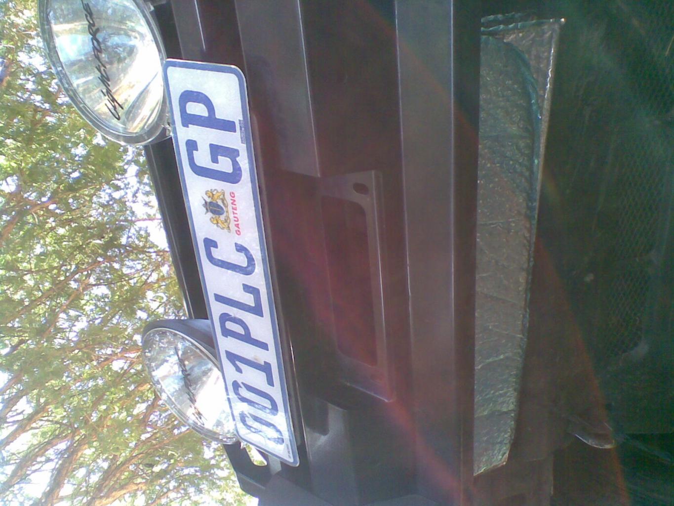

I see an aluminium plate in my future. And look at that number plate blocking the slot between the split panels!
Now I need to look at an original OEM front end.
