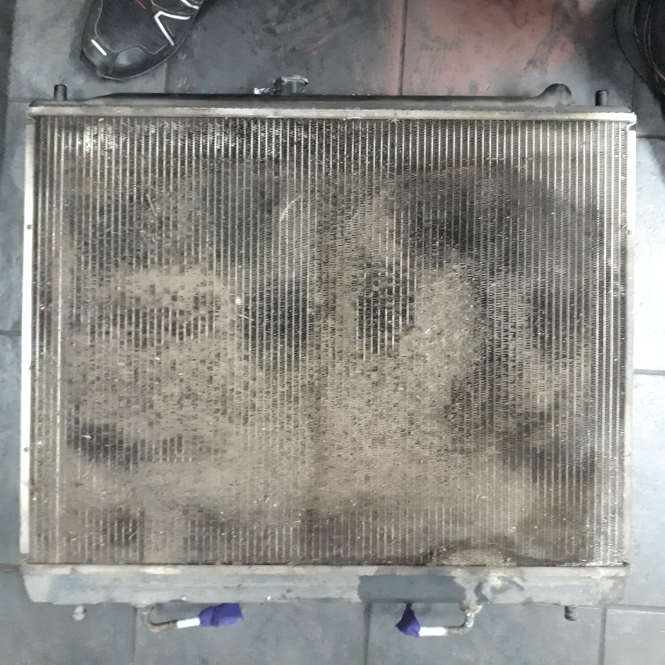

I recently did the following on my Pajero, after blowing a head gasket due to a blocked radiator @ 520,000km. After struggling to get a decent local mechanic willing to do the work, I decided to just do it myself. Transporting the car to MitsiTech would have been to expensive. Thus I did the following:
- Replace head (new AMC head & bolts)
- New head gasket and others (Victor Reinz)
- Install brand new radiator
- Flush/clean/pressure test the condenser, intercooler (gearbox oil cooler in process)

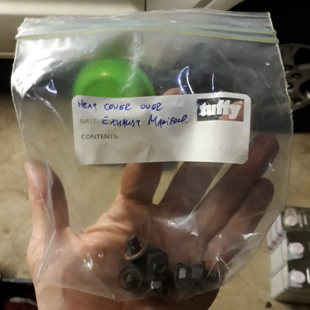

* Buy about 40 ziplock sandwich bags - use it to bag and label the bolts/parts as you take them off. Get a permanent maker pen and write on each bag a clear description. Stack the bags in the same order as the order in which you stripped - it gives you a very good idea in which order to reassemble. Get a box/container and stack them in there.
