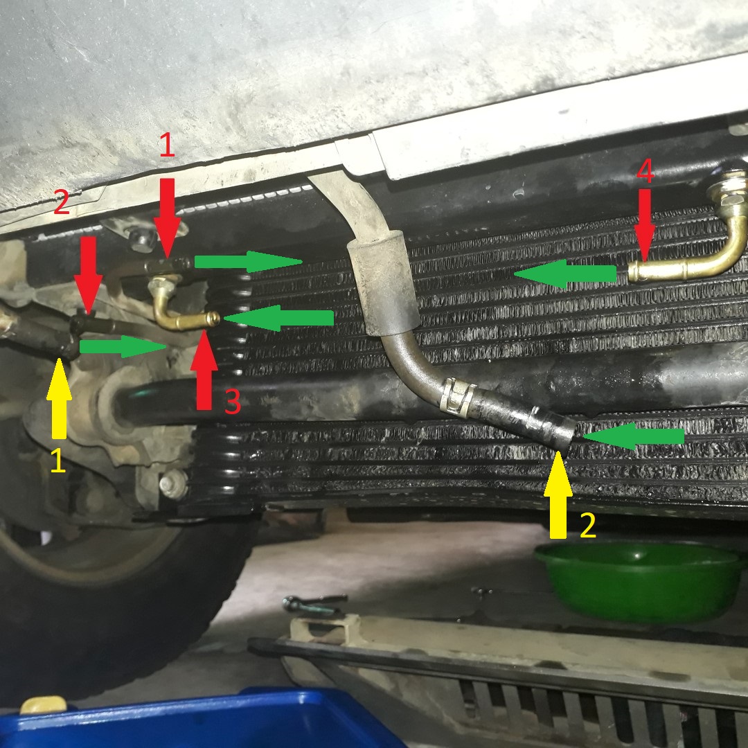

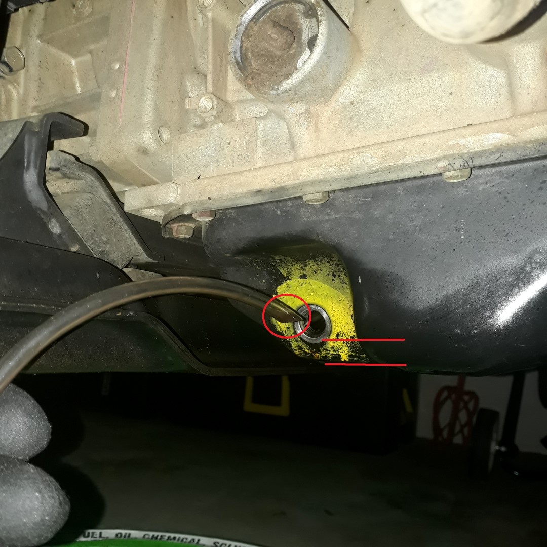

Gearbox drain
Gearbox drain
Gearbox oil cooler drain

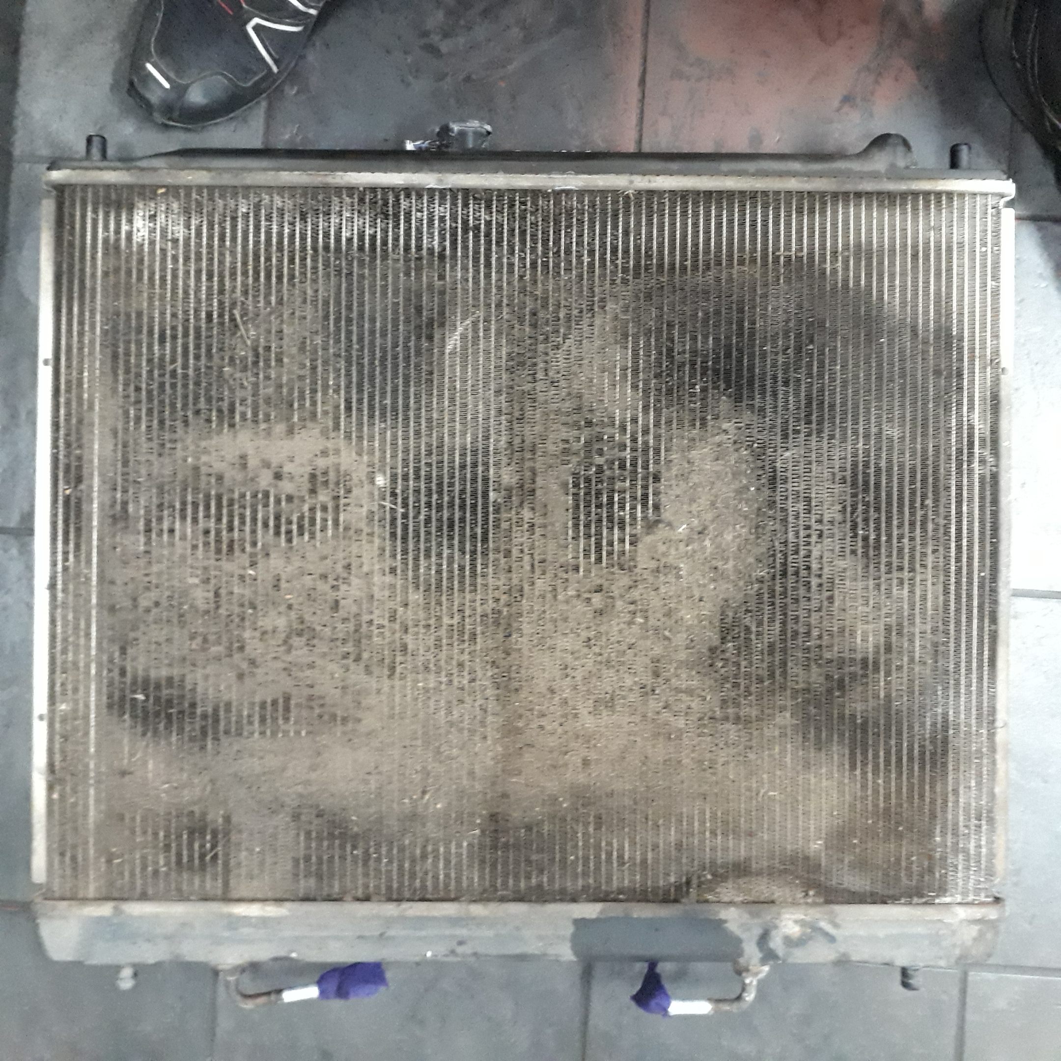

Blocked radiator
Blocked radiator

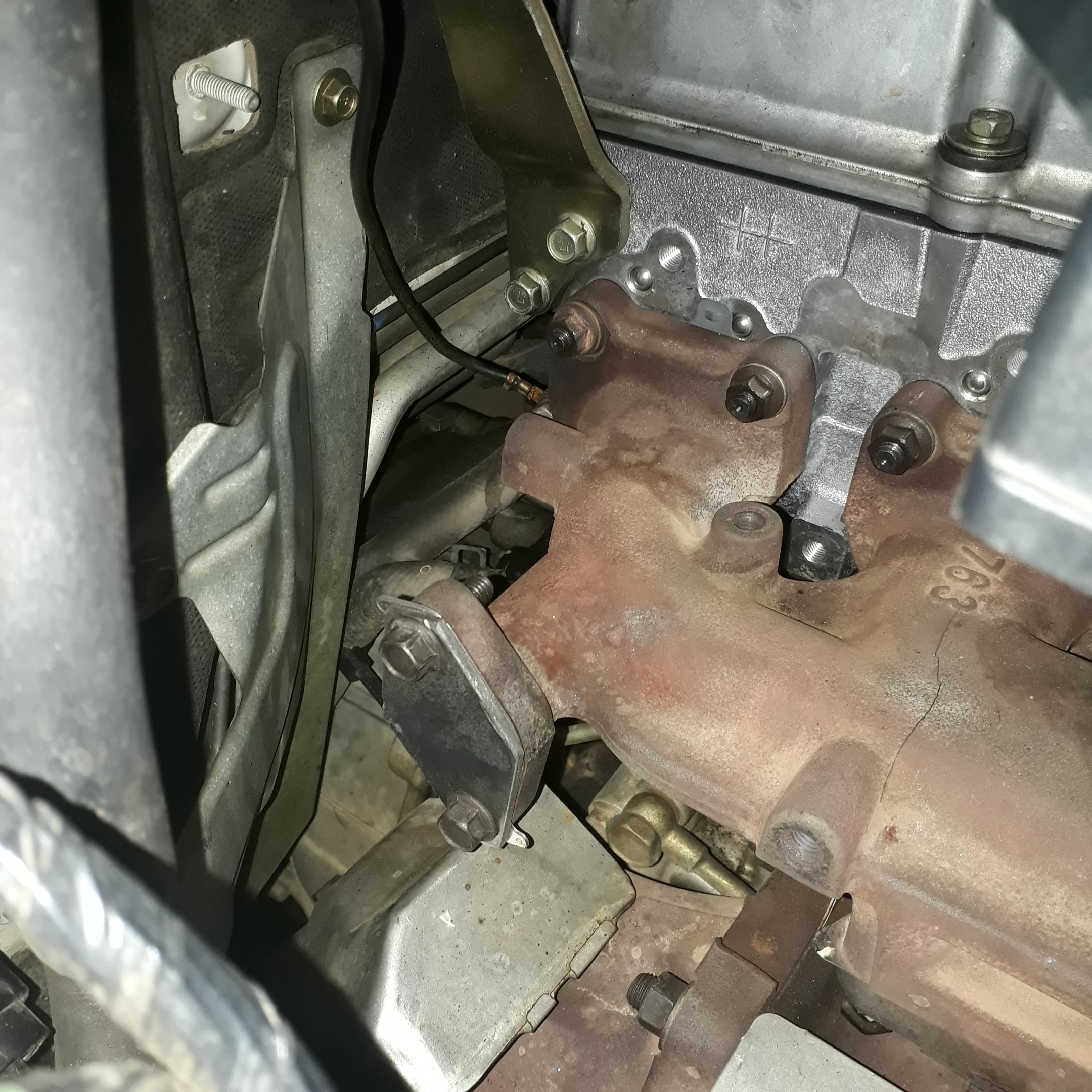

EGR blanked off
EGR blanked off
EGR blanked off
EGR blanked off

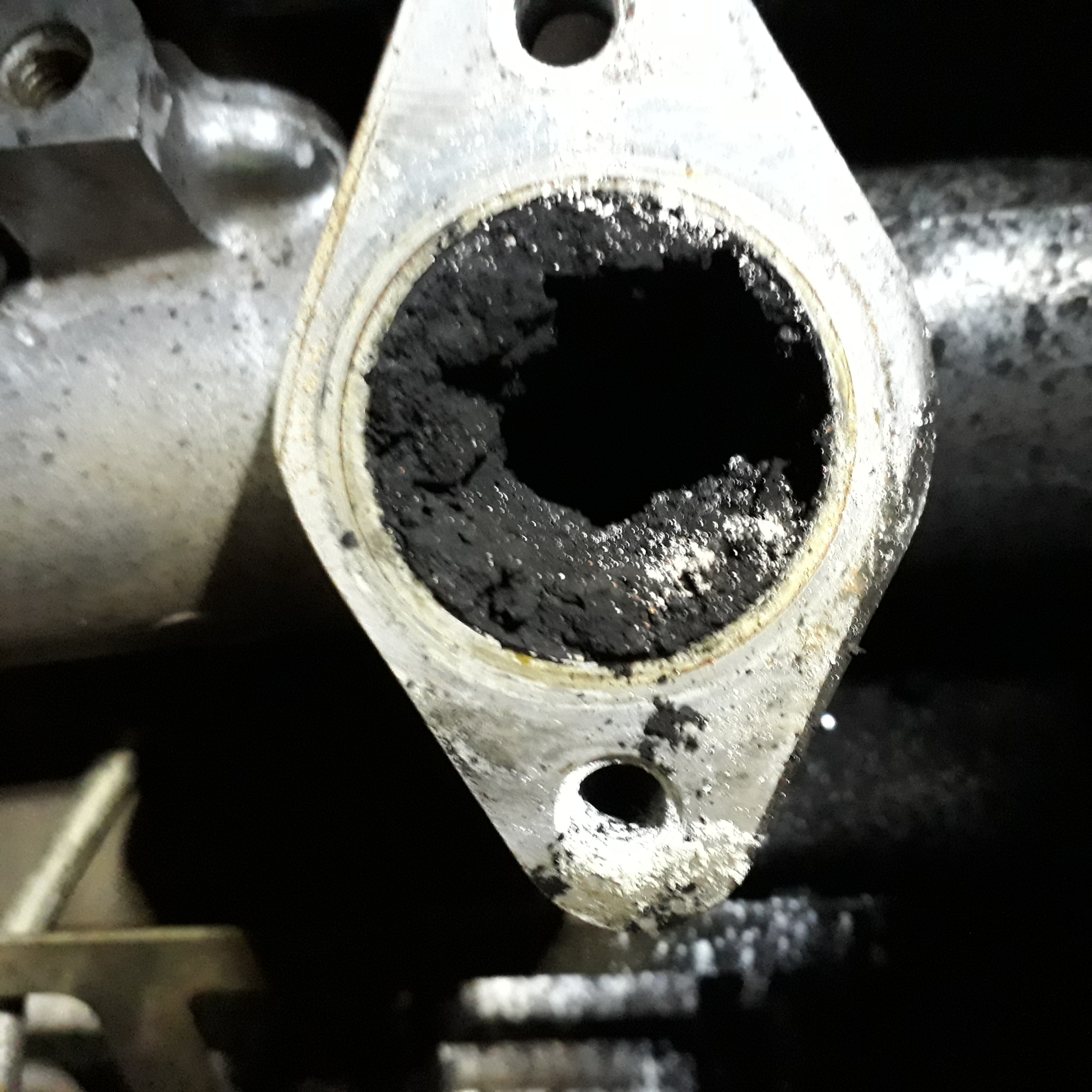

Blocked - EGR grit
Blocked - EGR grit

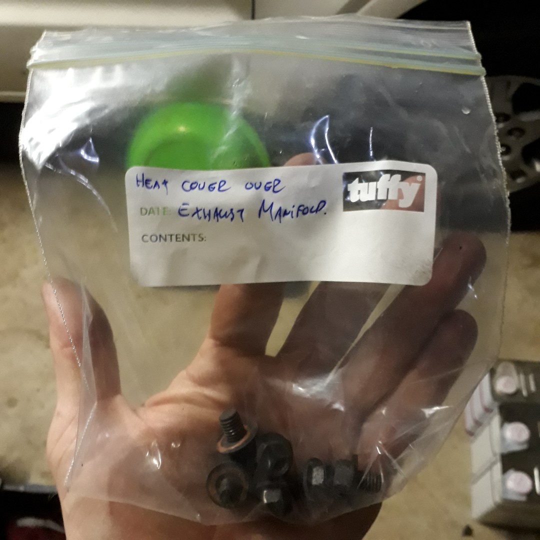

* Buy about 40 ziplock sandwich bags - use it to bag and label the bolts/parts as you take them off. Get a permanent maker pen and write on each bag a clear description. Stack the bags in the same order as the order in which you stripped - it gives you a very good idea in which order to reassemble. Get a box/container and stack them in there.

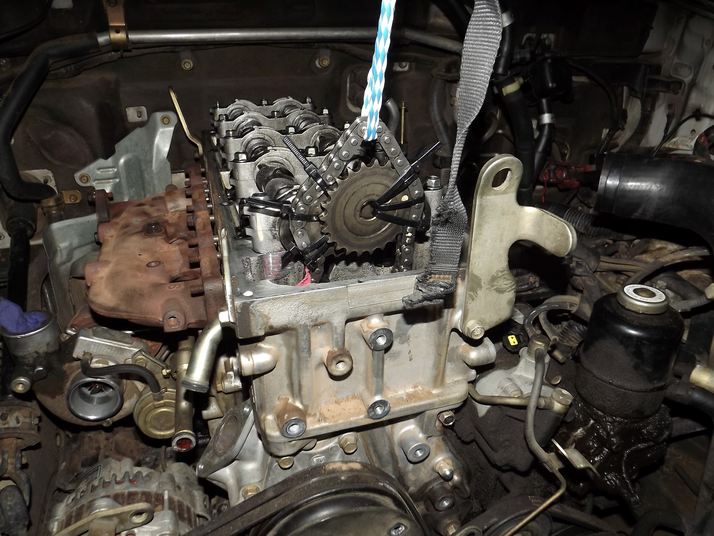

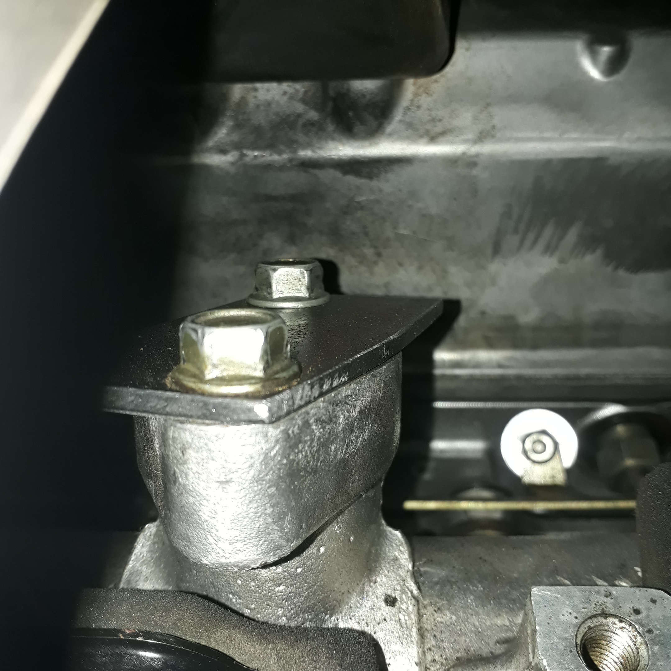

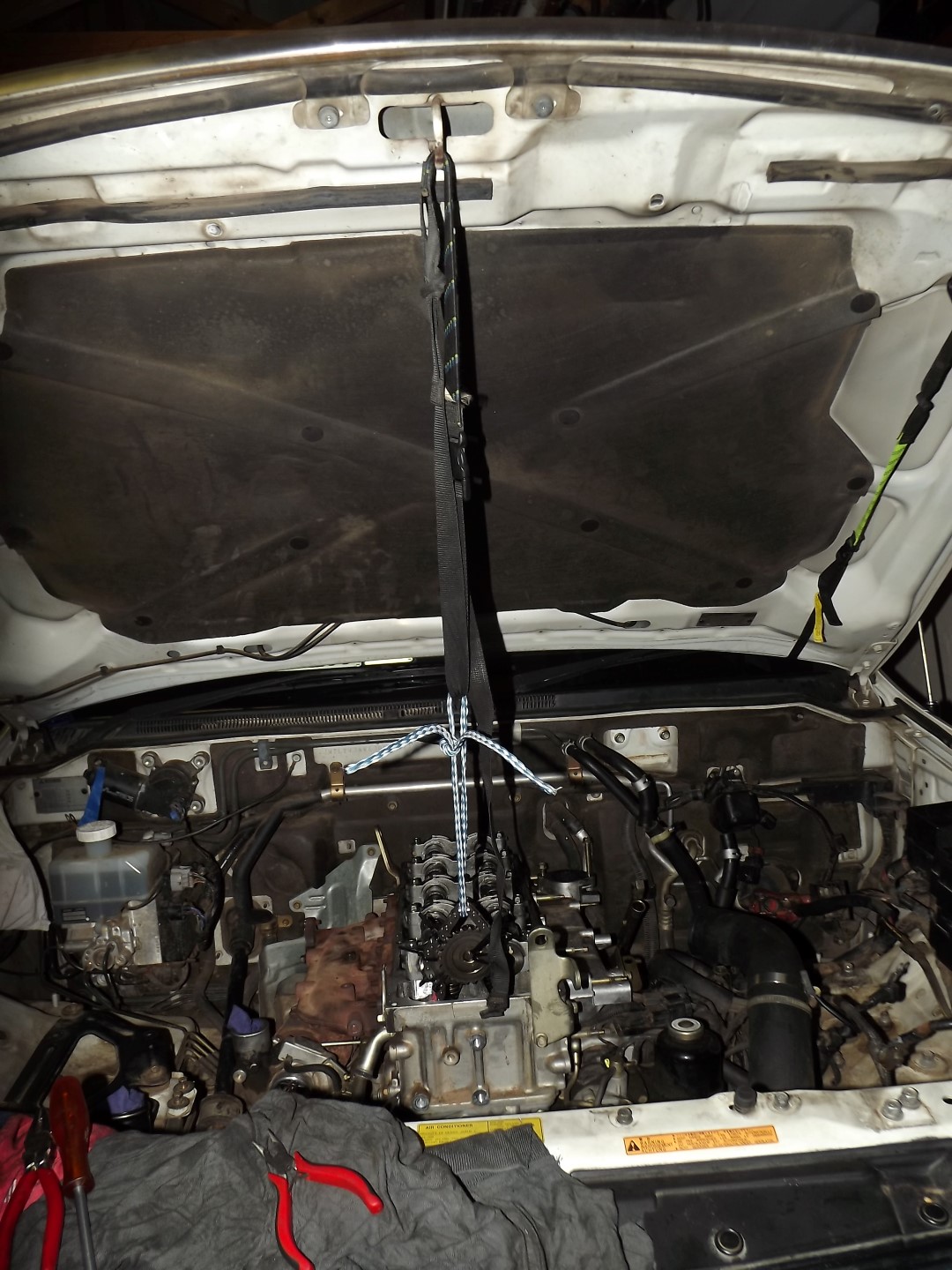

The trickiest/riskiest part was to keep tension on the timing chain when removing the cam shafts and subsequently the head itself. The video gives a good idea how to do this. I just added an extra step by using a Rox strap and rope, then tied it to the bonnet latch. Also secure the rod that keeps the bonnet open with a rope - you dont want that thing slipping and then cause the loss of tension on the timing chain.
Best to mark the pulleys' position on the chain before loosening anything - in case they also slip or move. Then fasten them with cable-ties together.
If the chain becomes slack, it could jump some teeth and that is a whole bunch of extra work which you dont really want to do. So, be very careful when doing it.
NOTE: Stuff paper or towels into the timing chain cavity to prevent items falling down into the motor.

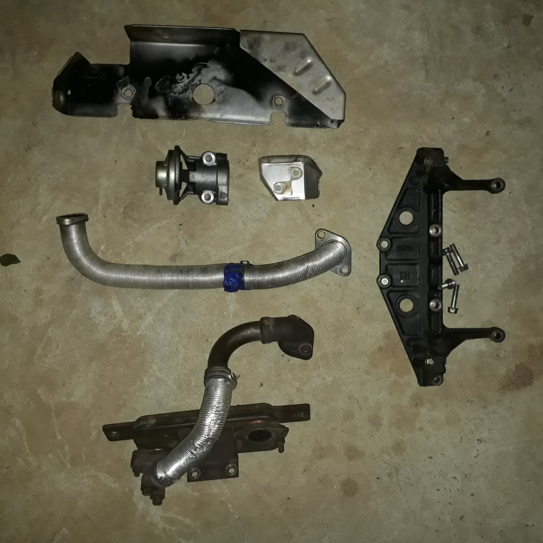

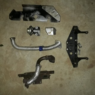

EGR piping and valve items removed.

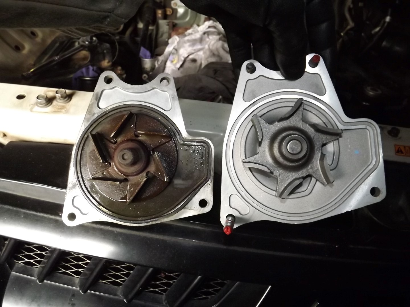

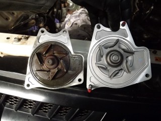

Old waterpump 520,000km VS new one (Alert Engine Parts).

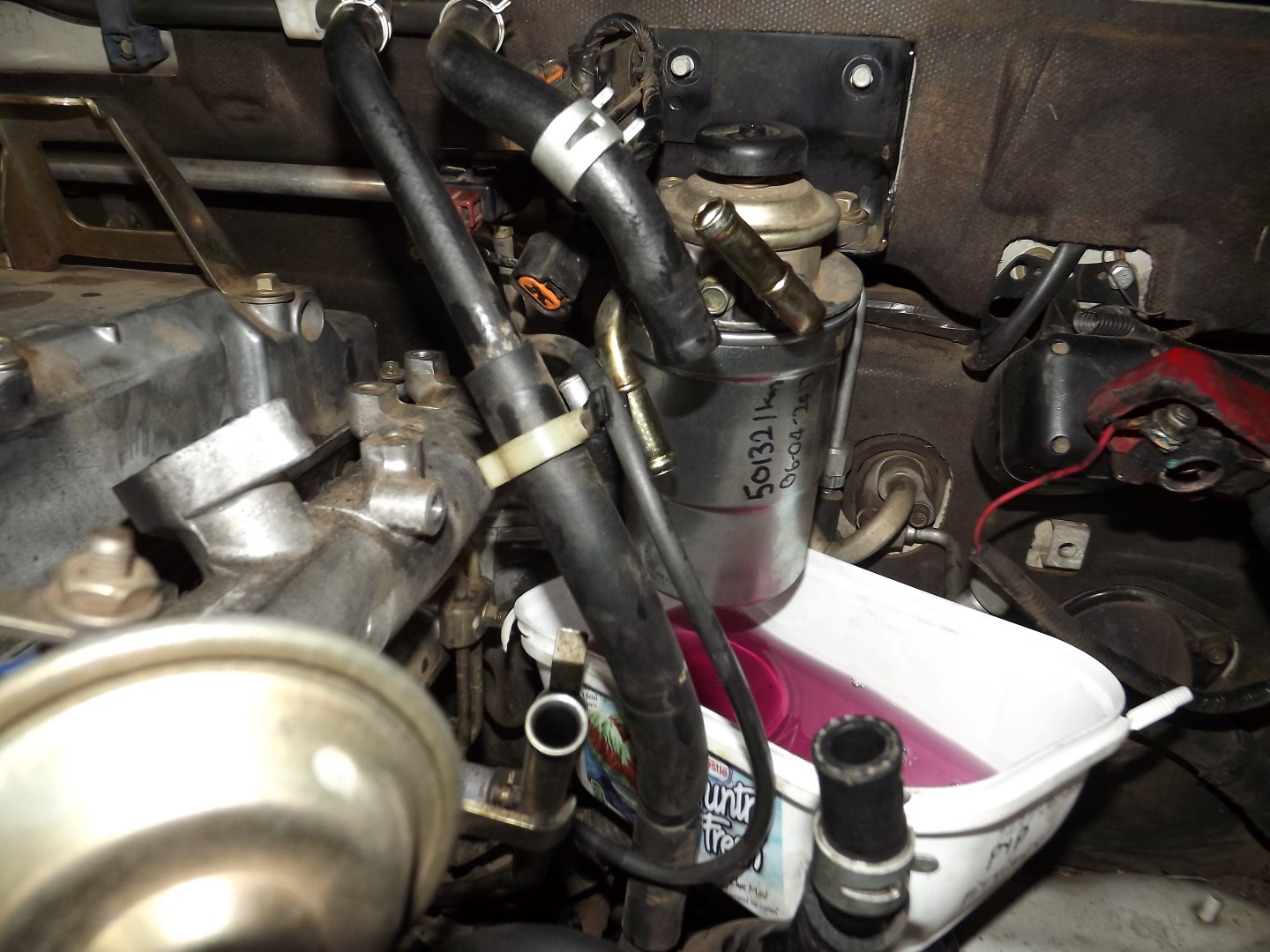

When removing the fuel filter - drain it by placing a container underneath as you unscrew everything. It is not good for your starter when pouring diesel all over it like that. I had to replace one or two starters because of this previously.
Also remember to plug those lines.
